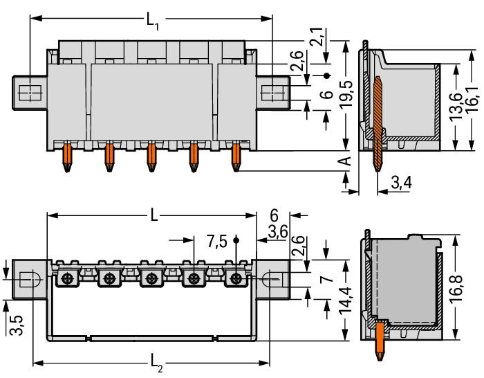

Datasheet Wago 2092-3405/005-000 — Даташит
Вилка THT; 1.4 mm Ø solder pin; прямые; зажимное кольцо; Шаг контактов 7,5 мм; 5-пол.
THT MALE HEADER; 1.4 MM SOLDER | |||
| 2092-3405/005-000 Wago | по запросу | ||
| Цвет | light gray |
| Connector connection type | for PCBs |
| Contact material | Electrolytic copper (Ecu) |
| Contact plating | tin-plated |
| Contact type (pluggable connector) | Male connector/plug |
| Country of origin | DE |
| Габариты: глубина | 14.4 mm / 0.567 inch |
| Drilled hole diameter (tolerance) | 1.6(+ 0.1) мм |
| Fire load | 0.092 MJ |
| Flammability class per UL94 | V0 |
| GTIN | 4050821165880 |
| Height | 23.1 mm / 0.909 inch |
| Height from the surface | 19.5 mm / 0.768 inch |
| Insulating material | Polyphtalamide (PPA GF) |
| Legend (ratings) | (III / 2) ≙ Overvoltage category III / Pollution degree 2 |
| Limit temperature range | -60 … +100 °C |
| Locking of plug-in connection | Male locking latch |
| Material group | I |
| Mating direction to the PCB | 90 ° |
| Mismating protection | No |
| Mounting type | Mounting flange |
| Number of Poles | 5 |
| Number of levels | 1 |
| PCB contact | THT |
| Pin spacing | 7.5 mm (0.295 inch) |
| Product Group | 26 (picoMAX) |
| Rated current | 16 A |
| Rated impulse voltage (II / 2) | 6 kV |
| Rated impulse voltage (III / 2) | 6 kV |
| Rated impulse voltage (III / 3) | 6 kV |
| Rated voltage (II / 2) | 1000 В |
| Rated voltage (III / 2) | 630 В |
| Rated voltage (III / 3) | 400 В |
| Solder pin diameter | 1.4 мм |
| Solder pin length | 3.6 мм |
| Total number of potentials | 5 |
| Type of mounting | Feed-through mounting Panel mounting |
| Вес | 4.12 г |
| Ширина | 49.2 mm / 1.937 inch |
