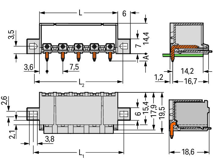

Datasheet Wago 2092-3425/005-000 — Даташит
Вилка THT; 1.4 mm Ø solder pin; угловые; зажимное кольцо; Шаг контактов 7,5 мм; 5-пол.
THT MALE HEADER; 1.4 MM SOLDER | |||
2092-3425/005-000 Wago | по запросу |
Цвет | light gray |
Connector connection type | for PCBs |
Contact material | Electrolytic copper (Ecu) |
Contact plating | tin-plated |
Contact type (pluggable connector) | Male connector/plug |
Country of origin | DE |
Габариты: глубина | 19.5 mm / 0.768 inch |
Drilled hole diameter (tolerance) | 1.6(+ 0.1) мм |
Fire load | 0.092 MJ |
GTIN | 4050821165965 |
Height | 18 mm / 0.709 inch |
Height from the surface | 14.4 mm / 0.567 inch |
Insulating material | Polyphtalamide (PPA GF) |
Legend (ratings) | (III / 2) ≙ Overvoltage category III / Pollution degree 2 |
Limit temperature range | -60 … +100 °C |
Locking of plug-in connection | Male locking latch |
Material group | I |
Mismating protection | No |
Mounting type | Mounting flange |
Number of Poles | 5 |
Number of levels | 1 |
PCB contact | THT |
Pin spacing | 7.5 mm (0.295 inch) |
Product Group | 26 (picoMAX) |
Rated current | 16 A |
Rated impulse voltage (II / 2) | 6 kV |
Rated impulse voltage (III / 2) | 6 kV |
Rated impulse voltage (III / 3) | 6 kV |
Rated voltage (II / 2) | 1000 В |
Rated voltage (III / 2) | 630 В |
Rated voltage (III / 3) | 400 В |
Solder pin diameter | 1.4 мм |
Solder pin length | 3.6 мм |
Total number of potentials | 5 |
Type of mounting | Feed-through mounting Panel mounting |
Вес | 4.22 г |
Ширина | 49.2 mm / 1.937 inch |
