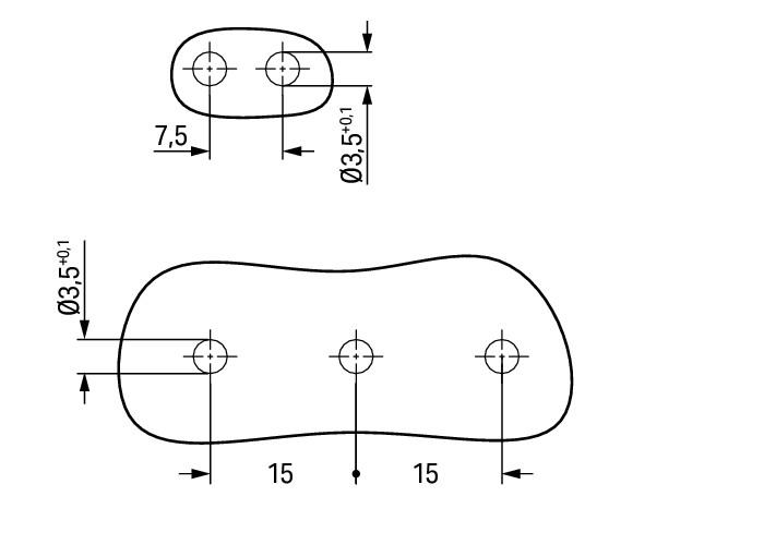

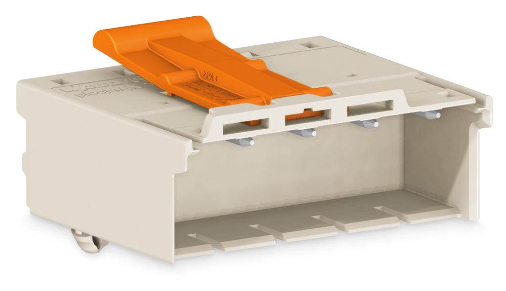

Datasheet Wago 2092-3525/020-000 — Даташит
1-проводная вилка; Монтажные ножки; 2,5 мм²; Шаг контактов 7,5 мм; 5-пол.
1-CONDUCTOR MALE CONNECTOR; SNAP | |||
2092-3525/020-000 Wago | по запросу |
Actuation type | Push-button |
Clamping spring material | Chrome nickel spring steel (CrNi) |
Цвет | light gray |
Connection technology | Push-in CAGE CLAMP® |
Connector connection type | for conductors |
Contact material | Electrolytic copper (Ecu) |
Contact plating | tin-plated |
Contact type (pluggable connector) | Male connector/plug |
Country of origin | DE |

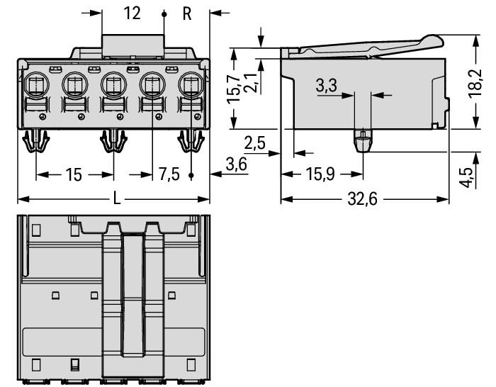

Габариты: глубина | 32.6 mm / 1.283 inch |
Fine-stranded conductor | 0.2 … 2.5 mm² / 24 … 12 AWG |
Fine-stranded conductor with ferrule with plastic collar | 0.25 … 1.5 mm² |
Fine-stranded conductor with ferrule without plastic collar | 0.25 … 2.5 mm² |
Fire load | 0.303 MJ |
GTIN | 4050821164906 |
Height | 22.7 mm / 0.894 inch |
Height from the surface | 18.2 mm / 0.717 inch |
Insulating material | Polyphtalamide (PPA GF) |
Legend (ratings) | (III / 2) ≙ Overvoltage category III / Pollution degree 2 |
Limit temperature range | -60 … +100 °C |
Locking of plug-in connection | Male locking latch |
Material group | I |
Mismating protection | No |
Number of Poles | 5 |
Number of connection types | 1 |
Number of levels | 1 |
Pin spacing | 7.5 mm (0.295 inch) |
Product Group | 26 (picoMAX) |
Rated current | 16 A |
Rated impulse voltage (II / 2) | 6 kV |
Rated impulse voltage (III / 2) | 6 kV |
Rated impulse voltage (III / 3) | 6 kV |
Rated voltage (II / 2) | 1000 В |
Rated voltage (III / 2) | 630 В |
Rated voltage (III / 3) | 400 В |
Solid conductor | 0.2 … 2.5 mm² / 24 … 12 AWG |
Strip length | 9 … 10 mm / 0.35 … 0.39 Inch |
Total number of connection points | 5 |
Total number of potentials | 5 |
Вес | 12.476 г |
Ширина | 37.2 mm / 1.465 inch |
Серия: 2092 (100 из 338)
- 2092-3102/002-1000 2092-3103 2092-3103/002-000 2092-3103/002-1000 2092-3104 2092-3104/002-000 2092-3105 2092-3105/002-000 2092-3105/002-1000 2092-3122 2092-3123 2092-3124 2092-3125 2092-3152 2092-3153 2092-3154 2092-3155 2092-3172 2092-3172/200-000 2092-3173 2092-3173/200-000 2092-3174 2092-3174/200-000 2092-3175 2092-3175/200-000 2092-3302 2092-3302/200-000 2092-3303 2092-3303/200-000 2092-3304 2092-3304/200-000 2092-3305 2092-3305/200-000 2092-3322 2092-3322/200-000 2092-3323 2092-3323/200-000 2092-3324 2092-3324/200-000 2092-3325 2092-3352 2092-3353 2092-3354 2092-3355 2092-3372 2092-3373 2092-3374 2092-3375 2092-3402 2092-3402/005-000 2092-3402/200-000 2092-3402/205-000 2092-3403 2092-3403/005-000 2092-3403/200-000 2092-3403/205-000 2092-3404 2092-3404/005-000 2092-3404/200-000 2092-3404/205-000 2092-3405 2092-3405/005-000 2092-3405/200-000 2092-3405/205-000 2092-3422 2092-3422/005-000 2092-3422/200-000 2092-3422/205-000 2092-3423 2092-3423/005-000 2092-3423/200-000 2092-3423/205-000 2092-3424 2092-3424/005-000 2092-3424/200-000 2092-3424/205-000 2092-3425 2092-3425/005-000 2092-3425/200-000 2092-3425/205-000 2092-3502/002-000 2092-3503/002-000 2092-3504/002-000 2092-3505/002-000 2092-3522/002-000 2092-3522/020-000 2092-3523/002-000 2092-3523/020-000 2092-3524/002-000 2092-3524/020-000 2092-3525/002-000 2092-3525/020-000 2092-3600 2092-3600/002-000 2092-3601 2092-3601/002-000 2092-3602 2092-3602/002-000 2092-3603 2092-3603/002-000
- PCB Interconnect | Pluggable Connection Systems
20923525/020000, 2092 3525/020 000
