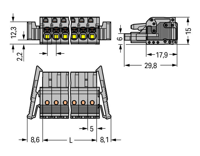

Actuation type | Push-button |
Clamping spring material | Chrome nickel spring steel (CrNi) |
Цвет | gray |
Connection technology | Push-in CAGE CLAMP® |
Connector connection type | for conductors |
Contact material | Copper alloy |
Contact plating | tin-plated |
Contact type (pluggable connector) | Female connector/socket |
Country of origin | PL |
Габариты: глубина | 50.6 mm / 1.992 inch |
Fine-stranded conductor | 0.2 … 2.5 mm² / 24 … 12 AWG |
Fine-stranded conductor with ferrule with plastic collar | 0.25 … 1.5 mm² |
Fine-stranded conductor with ferrule without plastic collar | 0.25 … 2.5 mm² |
Fire load | 0.185 MJ |
GTIN | 4050821349945 |
Height | 15 mm / 0.591 inch |
Legend (ratings) | (III / 2) ≙ Overvoltage category III / Pollution degree 2 |
Limit temperature range | -60 … +100 °C |
Material group | I |
Mismating protection | No |
Number of Poles | 5 |
Number of connection types | 1 |
Number of levels | 1 |
Pin spacing | 5 mm (0.197 inch) |
Rated current | 16 A |
Rated impulse voltage (II / 2) | 4 kV |
Rated impulse voltage (III / 2) | 4 kV |
Rated impulse voltage (III / 3) | 4 kV |
Rated voltage (II / 2) | 630 В |
Rated voltage (III / 2) | 320 В |
Rated voltage (III / 3) | 320 В |
Solid conductor | 0.2 … 2.5 mm² / 24 … 12 AWG |
Strip length | 10 … 11 mm / 0.39 … 0.43 Inch |
Total number of connection points | 5 |
Total number of potentials | 5 |
Вес | 8.678 г |
Ширина | 26.5 mm / 1.043 inch |
