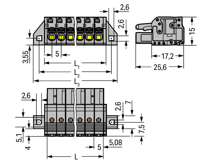

Datasheet Wago 2231-108/031-000 — Даташит
1-проводниковая розетка; Нажимная кнопка; зажимное кольцо; 2,5 мм²; Шаг контактов 5 мм; 8-пол.

Actuation type | Push-button |
Clamping spring material | Chrome nickel spring steel (CrNi) |
Цвет | gray |
Connection technology | Push-in CAGE CLAMP® |
Connector connection type | for conductors |
Contact material | Copper alloy |
Contact plating | tin-plated |
Contact type (pluggable connector) | Female connector/socket |
Country of origin | PL |
Габариты: глубина | 25.6 mm / 1.008 inch |
Fine-stranded conductor | 0.2 … 2.5 mm² / 24 … 12 AWG |
Fine-stranded conductor with ferrule with plastic collar | 0.25 … 1.5 mm² |
Fine-stranded conductor with ferrule without plastic collar | 0.25 … 2.5 mm² |
Fire load | 0.284 MJ |
GTIN | 4045454877071 |
Height | 15 mm / 0.591 inch |
Legend (ratings) | (III / 2) ≙ Overvoltage category III / Pollution degree 2 |
Limit temperature range | -60 … +100 °C |
Material group | I |
Mismating protection | No |
Mounting type | Mounting flange |
Number of Poles | 8 |
Number of connection types | 1 |
Number of levels | 1 |
Pin spacing | 5 mm (0.197 inch) |
Product Group | 3 (Multi Conn. System) |
Rated current | 16 A |
Rated impulse voltage (II / 2) | 4 kV |
Rated impulse voltage (III / 2) | 4 kV |
Rated impulse voltage (III / 3) | 4 kV |
Rated voltage (II / 2) | 630 В |
Rated voltage (III / 2) | 320 В |
Rated voltage (III / 3) | 320 В |
Solid conductor | 0.2 … 2.5 mm² / 24 … 12 AWG |
Strip length | 10 … 11 mm / 0.39 … 0.43 Inch |
Total number of connection points | 8 |
Total number of potentials | 8 |
Type of mounting | Feed-through mounting Panel mounting |
Вес | 13.404 г |
Ширина | 54.8 mm / 2.157 inch |
