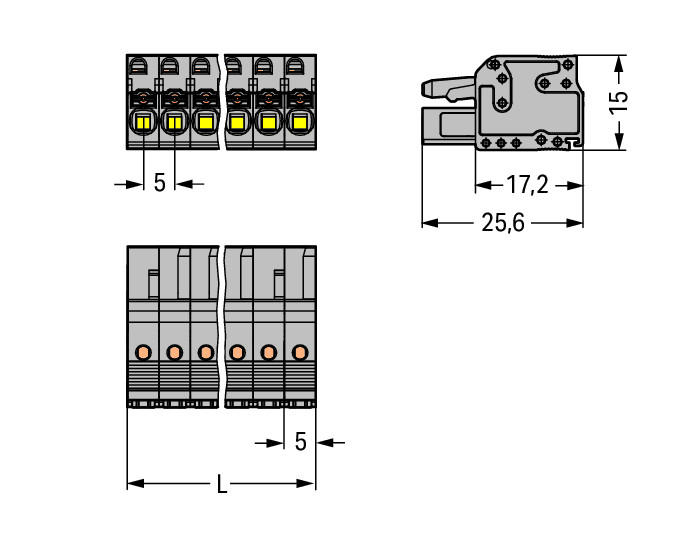

1-проводниковая розетка; Нажимная кнопка; со встроенной торцевой пластиной; 2,5 мм²; Шаг контактов 5 мм; 16-пол.
1-CONDUCTOR FEMALE PLUG; PUSH-BU | |||
| 2231-116/026-000 Wago | по запросу | ||
| 2231-116/008-000 Wago | по запросу | ||
| Actuation type | Push-button |
| Clamping spring material | Chrome nickel spring steel (CrNi) |
| Цвет | gray |
| Connection technology | Push-in CAGE CLAMP® |
| Connector connection type | for conductors |
| Contact material | Copper alloy |
| Contact plating | tin-plated |
| Contact type (pluggable connector) | Female connector/socket |
| Country of origin | PL |
| Габариты: глубина | 25.6 mm / 1.008 inch |
| Fine-stranded conductor | 0.2 … 2.5 mm² / 24 … 12 AWG |
| Fine-stranded conductor with ferrule with plastic collar | 0.25 … 1.5 mm² |
| Fine-stranded conductor with ferrule without plastic collar | 0.25 … 2.5 mm² |
| Fire load | 0.51 MJ |
| Flammability class per UL94 | V0 |
| GTIN | 4045454907761 |
| Height | 15 mm / 0.591 inch |
| Insulating material | Polyamide 66 (PA 66) |
| Legend (ratings) | (III / 2) ≙ Overvoltage category III / Pollution degree 2 |
| Limit temperature range | -60 … +100 °C |
| Material group | I |
| Mismating protection | No |
| Number of Poles | 16 |
| Number of connection types | 1 |
| Number of levels | 1 |
| Pin spacing | 5 mm (0.197 inch) |
| Plugging without loss of pin spacing | 1 |
| Product Group | 3 (Multi Conn. System) |
| Rated current | 16 A |
| Rated impulse voltage (II / 2) | 4 kV |
| Rated impulse voltage (III / 2) | 4 kV |
| Rated impulse voltage (III / 3) | 4 kV |
| Rated voltage (II / 2) | 630 В |
| Rated voltage (III / 2) | 320 В |
| Rated voltage (III / 3) | 320 В |
| Solid conductor | 0.2 … 2.5 mm² / 24 … 12 AWG |
| Strip length | 10 … 11 mm / 0.39 … 0.43 Inch |
| Total number of connection points | 16 |
| Total number of potentials | 16 |
| Вес | 24.928 г |
| Ширина | 80 mm / 3.15 inch |
