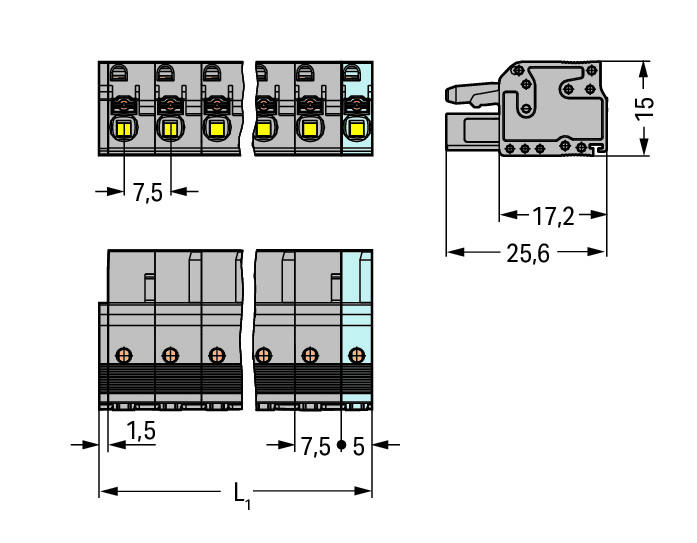

1-проводниковая розетка; Нажимная кнопка; 2,5 мм²; Шаг контактов 7,5 мм; 4-пол.
Augswan
2231-204/026-000
Wago
Wago 2231-204/026-000 Wago 2231-204/026-000
Actuation typePush-button
Clamping spring materialChrome nickel spring steel (CrNi)
Цветgray
Connection technologyPush-in CAGE CLAMP®
Connector connection typefor conductors
Contact materialCopper alloy
Contact platingtin-plated
Contact type (pluggable connector)Female connector/socket
Country of originPL
Габариты: глубина25.6 mm / 1.008 inch
Fine-stranded conductor0.2 … 2.5 mm² / 24 … 12 AWG
Fine-stranded conductor with ferrule with plastic collar0.25 … 1.5 mm²
Fine-stranded conductor with ferrule without plastic collar0.25 … 2.5 mm²
Fire load0.17 MJ
Flammability class per UL94V0
GTIN4045454722708
Height15 mm / 0.591 inch
Insulating materialPolyamide 66 (PA 66)
Legend (ratings)(III / 2) ≙ Overvoltage category III / Pollution degree 2
Limit temperature range-60 … +100 °C
Material groupI
Mismating protectionNo
Number of Poles4
Number of connection types1
Number of levels1
Pin spacing7.5 mm (0.295 inch)
Product Group3 (Multi Conn. System)
Rated current16 A
Rated impulse voltage (II / 2)6 kV
Rated impulse voltage (III / 2)6 kV
Rated impulse voltage (III / 3)6 kV
Rated voltage (II / 2)1000 В
Rated voltage (III / 2)630 В
Rated voltage (III / 3)500 В
Solid conductor0.2 … 2.5 mm² / 24 … 12 AWG
Strip length10 … 11 mm / 0.39 … 0.43 Inch
Total number of connection points4
Total number of potentials4
Вес7.702 г
Ширина29 mm / 1.142 inch
