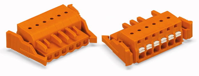

1-проводниковая розетка; Нажимная кнопка; Фиксирующий рычаг; 2,5 мм²; Шаг контактов 5,08 мм; 15-пол.
Augswan
2231-315/037-000
Wago
Wago 2231-315/037-000
Actuation typePush-button
Clamping spring materialChrome nickel spring steel (CrNi)
Цветorange
Connection technologyPush-in CAGE CLAMP®
Connector connection typefor conductors
Contact materialCopper alloy
Contact platingtin-plated
Contact type (pluggable connector)Female connector/socket
Country of originPL

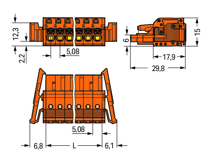

Габариты: глубина29.8 mm / 1.173 inch
Fine-stranded conductor0.2 … 2.5 mm² / 24 … 12 AWG
Fine-stranded conductor with ferrule with plastic collar0.25 … 1.5 mm²
Fine-stranded conductor with ferrule without plastic collar0.25 … 2.5 mm²
Fire load0.53 MJ
Flammability class per UL94V0
GTIN4045454873608
Height15 mm / 0.591 inch
Insulating materialPolyamide 66 (PA 66)
Legend (ratings)(III / 2) ≙ Overvoltage category III / Pollution degree 2
Limit temperature range-60 … +100 °C
Locking of plug-in connectionlocking lever
Material groupI
Mismating protectionNo
Number of Poles15
Number of connection types1
Number of levels1
Pin spacing5.08 mm (0.2 inch)
Product Group3 (Multi Conn. System)
Rated current16 A
Rated impulse voltage (II / 2)4 kV
Rated impulse voltage (III / 2)4 kV
Rated impulse voltage (III / 3)4 kV
Rated voltage (II / 2)630 В
Rated voltage (III / 2)320 В
Rated voltage (III / 3)320 В
Solid conductor0.2 … 2.5 mm² / 24 … 12 AWG
Strip length10 … 11 mm / 0.39 … 0.43 Inch
Total number of connection points15
Total number of potentials15
Вес25.19 г
Ширина92.9 mm / 3.657 inch
