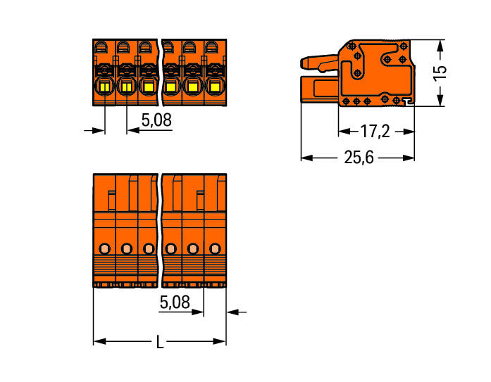

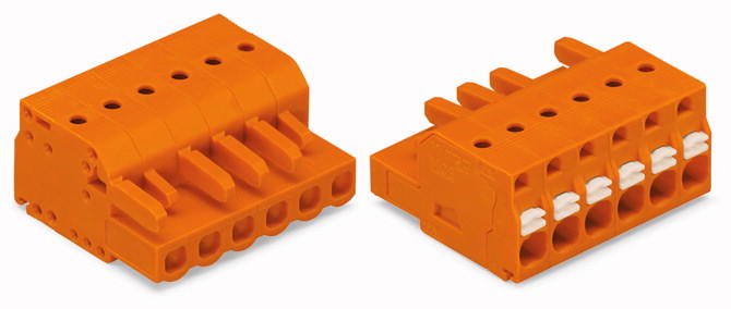

1-проводниковая розетка; Нажимная кнопка; со встроенной торцевой пластиной; 2,5 мм²; Шаг контактов 5,08 мм; 18-пол.
1-CONDUCTOR FEMALE PLUG; PUSH-BU | |||
2231-318/102-000 Wago | по запросу |
Actuation type | Push-button |
Clamping spring material | Chrome nickel spring steel (CrNi) |
Цвет | orange |
Connection technology | Push-in CAGE CLAMP® |
Connector connection type | for conductors |
Contact material | Copper alloy |
Contact plating | tin-plated |
Contact type (pluggable connector) | Female connector/socket |
Country of origin | PL |
Габариты: глубина | 25.6 mm / 1.008 inch |
Fine-stranded conductor | 0.2 … 2.5 mm² / 24 … 12 AWG |
Fine-stranded conductor with ferrule with plastic collar | 0.25 … 1.5 mm² |
Fine-stranded conductor with ferrule without plastic collar | 0.25 … 2.5 mm² |
Fire load | 0.574 MJ |
GTIN | 4045454908065 |
Height | 15 mm / 0.591 inch |
Legend (ratings) | (III / 2) ≙ Overvoltage category III / Pollution degree 2 |
Limit temperature range | -60 … +100 °C |
Material group | I |
Mismating protection | No |
Number of Poles | 18 |
Number of connection types | 1 |
Number of levels | 1 |
Pin spacing | 5.08 mm (0.2 inch) |
Plugging without loss of pin spacing | 1 |
Product Group | 3 (Multi Conn. System) |
Rated current | 16 A |
Rated impulse voltage (II / 2) | 4 kV |
Rated impulse voltage (III / 2) | 4 kV |
Rated impulse voltage (III / 3) | 4 kV |
Rated voltage (II / 2) | 630 В |
Rated voltage (III / 2) | 320 В |
Rated voltage (III / 3) | 320 В |
Solid conductor | 0.2 … 2.5 mm² / 24 … 12 AWG |
Strip length | 10 … 11 mm / 0.39 … 0.43 Inch |
Total number of connection points | 18 |
Total number of potentials | 18 |
Вес | 28.154 г |
Ширина | 91.44 mm / 3.6 inch |
