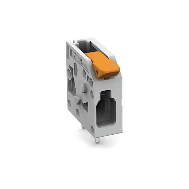

Actuating element color | orange |
Actuation type | Lever |
Clamping spring material | Chrome nickel spring steel (CrNi) |
Цвет | gray |
Connection technology | Push-in CAGE CLAMP® |
Contact material | Electrolytic copper (Ecu) |
Contact plating | tin-plated |
Country of origin | DE |
Габариты: глубина | 19.2 mm / 0.756 inch |
Drilled hole diameter (tolerance) | 1.3(+ 0.1) мм |
Fine-stranded conductor | 0.2 … 4 mm² / 24 … 12 AWG |
Fine-stranded conductor with ferrule with plastic collar | 0.25 … 2.5 mm² |
Fine-stranded conductor with ferrule without plastic collar | 0.25 … 2.5 mm² |
Fine-stranded conductor, with twin ferrule | 0.25 … 1.5 mm² |
GTIN | 4055143564281 |
Height | 20.7 mm / 0.815 inch |
Height from the surface | 16.7 mm / 0.657 inch |
Legend (ratings) | (III / 2) ≙ Overvoltage category III / Pollution degree 2 |
Limit temperature range | -60 … +105 °C |
Material group | I |
Number of Poles | 1 |
Number of connection types | 1 |
Number of levels | 1 |
Number of solder pins per potential | 2 |
PCB contact | THT |
Pin spacing | 5 mm (0.197 inch) |
Rated current | 32 A |
Rated impulse voltage (II / 2) | 4 kV |
Rated impulse voltage (III / 2) | 4 kV |
Rated impulse voltage (III / 3) | 4 kV |
Rated voltage (II / 2) | 630 В |
Rated voltage (III / 2) | 400 В |
Rated voltage (III / 3) | 320 В |
Solder pin arrangement | within the terminal block, in line |
Solder pin dimensions | 0.8 x 1 mm |
Solder pin length | 4 мм |
Solid conductor | 0.2 … 4 mm² / 24 … 12 AWG |
Strip length | 9 … 11 mm / 0.35 … 0.43 Inch |
Total number of connection points | 1 |
Total number of potentials | 1 |
Вес | 1.797 г |
Ширина | 7.4 mm / 0.291 inch |
