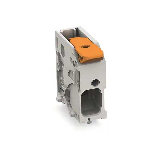

Клеммная колодка для печатной платы; рычаг; 6 мм²; Шаг контактов 7,5 мм; 1-полюсный; Зажим Push-in CAGE CLAMP

| Actuating element color | orange |
| Actuation type | Lever |
| Clamping spring material | Chrome nickel spring steel (CrNi) |
| Цвет | gray |
| Connection technology | Push-in CAGE CLAMP® |
| Contact material | Electrolytic copper (Ecu) |
| Contact plating | tin-plated |
| Country of origin | DE |
| Габариты: глубина | 24.3 mm / 0.957 inch |
| Drilled hole diameter (tolerance) | 2(+ 0.1) мм |
| Fine-stranded conductor | 0.2 … 10 mm² / 24 … 8 AWG |
| Fine-stranded conductor with ferrule with plastic collar | 0.25 … 6 mm² |
| Fine-stranded conductor with ferrule without plastic collar | 0.25 … 6 mm² |
| Fine-stranded conductor, with twin ferrule | 0.25 … 2.5 mm² |
| Flammability class per UL94 | V0 |
| GTIN | 4055143586405 |
| Height | 28 mm / 1.102 inch |
| Height from the surface | 24 mm / 0.945 inch |
| Insulating material | Polyamide 66 (PA 66) |
| Legend (ratings) | (III / 2) ≙ Overvoltage category III / Pollution degree 2 |
| Limit temperature range | -60 … +105 °C |
| Material group | I |
| Number of Poles | 1 |
| Number of connection types | 1 |
| Number of levels | 1 |
| Number of solder pins per potential | 1 |
| PCB contact | THT |
| Pin spacing | 7.5 mm (0.295 inch) |
| Rated current | 41 A |
| Rated impulse voltage (II / 2) | 8 kV |
| Rated impulse voltage (III / 2) | 8 kV |
| Rated impulse voltage (III / 3) | 8 kV |
| Rated voltage (II / 2) | 1000 В |
| Rated voltage (III / 2) | 1000 В |
| Rated voltage (III / 3) | 800 В |
| Solder pin arrangement | within the terminal block, in line |
| Solder pin dimensions | 1.5 x 1.2 mm |
| Solder pin length | 4 мм |
| Solid conductor | 0.2 … 10 mm² / 24 … 8 AWG |
| Strip length | 11 … 13 mm / 0.43 … 0.51 Inch |
| Total number of connection points | 1 |
| Total number of potentials | 1 |
| Вес | 4.421 г |
| Ширина | 10.35 mm / 0.407 inch |
