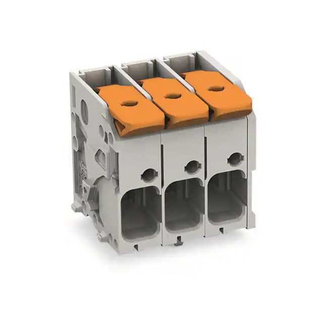

Datasheet Wago 2606-1103/010-000 — Даташит
Клеммная колодка для печатной платы; рычаг; 6 мм²; Шаг контактов 7,5 мм; 3-полюсный; Зажим Push-in CAGE CLAMP

Actuating element color | orange |
Actuation type | Lever |
Clamping spring material | Chrome nickel spring steel (CrNi) |
Цвет | gray |
Connection technology | Push-in CAGE CLAMP® |
Contact material | Electrolytic copper (Ecu) |
Contact plating | tin-plated |
Country of origin | DE |
Габариты: глубина | 24.3 mm / 0.957 inch |
Drilled hole diameter (tolerance) | 2(+ 0.1) мм |
Fine-stranded conductor | 0.2 … 10 mm² / 24 … 8 AWG |
Fine-stranded conductor with ferrule with plastic collar | 0.25 … 6 mm² |
Fine-stranded conductor with ferrule without plastic collar | 0.25 … 6 mm² |
Fine-stranded conductor, with twin ferrule | 0.25 … 2.5 mm² |
GTIN | 4055143662673 |
Height | 28 mm / 1.102 inch |
Height from the surface | 24 mm / 0.945 inch |
Legend (ratings) | (III / 2) ≙ Overvoltage category III / Pollution degree 2 |
Limit temperature range | -60 … +105 °C |
Material group | I |
Number of Poles | 3 |
Number of connection types | 1 |
Number of levels | 1 |
Number of solder pins per potential | 1 |
PCB contact | THT |
Pin spacing | 7.5 mm (0.295 inch) |
Rated current | 41 A |
Rated impulse voltage (II / 2) | 8 kV |
Rated impulse voltage (III / 2) | 8 kV |
Rated impulse voltage (III / 3) | 8 kV |
Rated voltage (II / 2) | 1000 В |
Rated voltage (III / 2) | 1000 В |
Rated voltage (III / 3) | 800 В |
Solder pin arrangement | over the entire terminal strip, staggered |
Solder pin dimensions | 1.5 x 1.2 mm |
Solder pin length | 4 мм |
Solid conductor | 0.2 … 10 mm² / 24 … 8 AWG |
Strip length | 11 … 13 mm / 0.43 … 0.51 Inch |
Total number of potentials | 3 |
Вес | 11.871 г |
Ширина | 25.35 mm / 0.998 inch |
