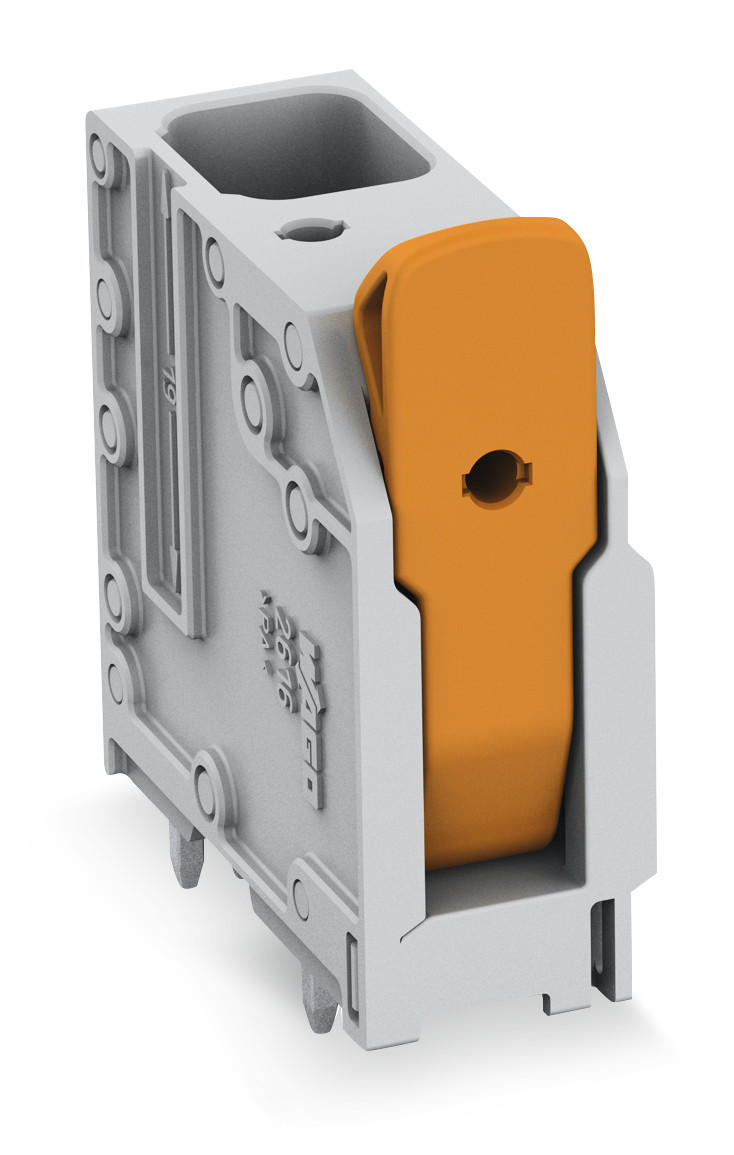

Parameters / Models | 2616-1101![]() | 2616-1102/020-000![]() | 2616-1102/020-023![]() | 2616-1103/020-000![]() | 2616-1104/020-000![]() | 2616-1105/020-000![]() | 2616-1105/020-015![]() | 2616-1106/020-000![]() | 2616-1107/020-000![]() | 2616-1108/020-000![]() | 2616-1109/020-000![]() | 2616-1110/020-000![]() | 2616-1111/020-000![]() | 2616-1112/020-000![]() | 2616-3101![]() | 2616-3102/020-000![]() | 2616-3103/020-000![]() | 2616-3104/020-000![]() | 2616-3105/020-000![]() | 2616-3106/020-000![]() | 2616-3107/020-000![]() | 2616-3108/020-000![]() | 2616-3109/020-000![]() | 2616-3110/020-000![]() | 2616-3111/020-000![]() | 2616-3112/020-000![]() |
Actuating element color | orange | orange | orange | orange | orange | orange | orange | orange | orange | orange | orange | orange | orange | orange | orange | orange | orange | orange | orange | orange | orange | orange | orange | orange | orange | orange |
Actuation type | Lever | Lever | Lever | Lever | Lever | Lever | Lever | Lever | Lever | Lever | Lever | Lever | Lever | Lever | Lever | Lever | Lever | Lever | Lever | Lever | Lever | Lever | Lever | Lever | Lever | Lever |
Clamping spring material | Chrome nickel spring steel (CrNi) | Chrome nickel spring steel (CrNi) | Chrome nickel spring steel (CrNi) | Chrome nickel spring steel (CrNi) | Chrome nickel spring steel (CrNi) | Chrome nickel spring steel (CrNi) | Chrome nickel spring steel (CrNi) | Chrome nickel spring steel (CrNi) | Chrome nickel spring steel (CrNi) | Chrome nickel spring steel (CrNi) | Chrome nickel spring steel (CrNi) | Chrome nickel spring steel (CrNi) | Chrome nickel spring steel (CrNi) | Chrome nickel spring steel (CrNi) | Chrome nickel spring steel (CrNi) | Chrome nickel spring steel (CrNi) | Chrome nickel spring steel (CrNi) | Chrome nickel spring steel (CrNi) | Chrome nickel spring steel (CrNi) | Chrome nickel spring steel (CrNi) | Chrome nickel spring steel (CrNi) | Chrome nickel spring steel (CrNi) | Chrome nickel spring steel (CrNi) | Chrome nickel spring steel (CrNi) | Chrome nickel spring steel (CrNi) | Chrome nickel spring steel (CrNi) |
Цвет | gray | gray | green | gray | gray | gray | gentian blue | gray | gray | gray | gray | gray | gray | gray | gray | gray | gray | gray | gray | gray | gray | gray | gray | gray | gray | gray |
Conductor entry angle to the PCB, ° | 90 | 90 | 90 | 90 | 90 | 90 | 90 | 90 | 90 | 90 | 90 | 90 | ||||||||||||||
Connection technology | Push-in CAGE CLAMP® | Push-in CAGE CLAMP® | Push-in CAGE CLAMP® | Push-in CAGE CLAMP® | Push-in CAGE CLAMP® | Push-in CAGE CLAMP® | Push-in CAGE CLAMP® | Push-in CAGE CLAMP® | Push-in CAGE CLAMP® | Push-in CAGE CLAMP® | Push-in CAGE CLAMP® | Push-in CAGE CLAMP® | Push-in CAGE CLAMP® | Push-in CAGE CLAMP® | Push-in CAGE CLAMP® | Push-in CAGE CLAMP® | Push-in CAGE CLAMP® | Push-in CAGE CLAMP® | Push-in CAGE CLAMP® | Push-in CAGE CLAMP® | Push-in CAGE CLAMP® | Push-in CAGE CLAMP® | Push-in CAGE CLAMP® | Push-in CAGE CLAMP® | Push-in CAGE CLAMP® | Push-in CAGE CLAMP® |
Contact material | Electrolytic copper (Ecu) | Electrolytic copper (Ecu) | Electrolytic copper (Ecu) | Electrolytic copper (Ecu) | Electrolytic copper (Ecu) | Electrolytic copper (Ecu) | Electrolytic copper (Ecu) | Electrolytic copper (Ecu) | Electrolytic copper (Ecu) | Electrolytic copper (Ecu) | Electrolytic copper (Ecu) | Electrolytic copper (Ecu) | Electrolytic copper (Ecu) | Electrolytic copper (Ecu) | Electrolytic copper (Ecu) | Electrolytic copper (Ecu) | Electrolytic copper (Ecu) | Electrolytic copper (Ecu) | Electrolytic copper (Ecu) | Electrolytic copper (Ecu) | Electrolytic copper (Ecu) | Electrolytic copper (Ecu) | Electrolytic copper (Ecu) | Electrolytic copper (Ecu) | Electrolytic copper (Ecu) | Electrolytic copper (Ecu) |
Contact plating | tin-plated | tin-plated | tin-plated | tin-plated | tin-plated | tin-plated | tin-plated | tin-plated | tin-plated | tin-plated | tin-plated | tin-plated | tin-plated | tin-plated | tin-plated | tin-plated | tin-plated | tin-plated | tin-plated | tin-plated | tin-plated | tin-plated | tin-plated | tin-plated | tin-plated | tin-plated |
Country of origin | DE | DE | DE | DE | DE | DE | DE | DE | DE | DE | DE | DE | DE | DE | DE | DE | DE | DE | DE | DE | DE | DE | DE | DE | DE | DE |
Габариты: глубина | 32 mm / 1.26 inch | 32 mm / 1.26 inch | 32 mm / 1.26 inch | 32 mm / 1.26 inch | 32 mm / 1.26 inch | 32 mm / 1.26 inch | 32 mm / 1.26 inch | 32 mm / 1.26 inch | 32 mm / 1.26 inch | 32 mm / 1.26 inch | 32 mm / 1.26 inch | 32 mm / 1.26 inch | 32 mm / 1.26 inch | 32 mm / 1.26 inch | 29.4 mm / 1.157 inch | 29.4 mm / 1.157 inch | 29.4 mm / 1.157 inch | 29.4 mm / 1.157 inch | 29.4 mm / 1.157 inch | 29.4 mm / 1.157 inch | 29.4 mm / 1.157 inch | 29.4 mm / 1.157 inch | 29.4 mm / 1.157 inch | 29.4 mm / 1.157 inch | 29.4 mm / 1.157 inch | 29.4 mm / 1.157 inch |
Drilled hole diameter (tolerance), мм | 1.7(+ 0.1) | 1.7(+ 0.1) | 1.7(+ 0.1) | 1.7(+ 0.1) | 1.7(+ 0.1) | 1.7(+ 0.1) | 1.7(+ 0.1) | 1.7(+ 0.1) | 1.7(+ 0.1) | 1.7(+ 0.1) | 1.7(+ 0.1) | 1.7(+ 0.1) | 1.7(+ 0.1) | 1.7(+ 0.1) | 1.7(+ 0.1) | 1.7(+ 0.1) | 1.7(+ 0.1) | 1.7(+ 0.1) | 1.7(+ 0.1) | 1.7(+ 0.1) | 1.7(+ 0.1) | 1.7(+ 0.1) | 1.7(+ 0.1) | 1.7(+ 0.1) | 1.7(+ 0.1) | 1.7(+ 0.1) |
Fine-stranded conductor | 0.75 … 25 mm² / 18 … 4 AWG | 0.75 … 25 mm² / 18 … 4 AWG | 0.75 … 25 mm² / 18 … 4 AWG | 0.75 … 25 mm² / 18 … 4 AWG | 0.75 … 25 mm² / 18 … 4 AWG | 0.75 … 25 mm² / 18 … 4 AWG | 0.75 … 25 mm² / 18 … 4 AWG | 0.75 … 25 mm² / 18 … 4 AWG | 0.75 … 25 mm² / 18 … 4 AWG | 0.75 … 25 mm² / 18 … 4 AWG | 0.75 … 25 mm² / 18 … 4 AWG | 0.75 … 25 mm² / 18 … 4 AWG | 0.75 … 25 mm² / 18 … 4 AWG | 0.75 … 25 mm² / 18 … 4 AWG | 0.75 … 25 mm² / 18 … 4 AWG | 0.75 … 25 mm² / 18 … 4 AWG | 0.75 … 25 mm² / 18 … 4 AWG | 0.75 … 25 mm² / 18 … 4 AWG | 0.75 … 25 mm² / 18 … 4 AWG | 0.75 … 25 mm² / 18 … 4 AWG | 0.75 … 25 mm² / 18 … 4 AWG | 0.75 … 25 mm² / 18 … 4 AWG | 0.75 … 25 mm² / 18 … 4 AWG | 0.75 … 25 mm² / 18 … 4 AWG | 0.75 … 25 mm² / 18 … 4 AWG | 0.75 … 25 mm² / 18 … 4 AWG |
Fine-stranded conductor with ferrule with plastic collar | 0.75 … 16 mm² | 0.75 … 16 mm² | 0.75 … 16 mm² | 0.75 … 16 mm² | 0.75 … 16 mm² | 0.75 … 16 mm² | 0.75 … 16 mm² | 0.75 … 16 mm² | 0.75 … 16 mm² | 0.75 … 16 mm² | 0.75 … 16 mm² | 0.75 … 16 mm² | 0.75 … 16 mm² | 0.75 … 16 mm² | 0.75 … 16 mm² | 0.75 … 16 mm² | 0.75 … 16 mm² | 0.75 … 16 mm² | 0.75 … 16 mm² | 0.75 … 16 mm² | 0.75 … 16 mm² | 0.75 … 16 mm² | 0.75 … 16 mm² | 0.75 … 16 mm² | 0.75 … 16 mm² | 0.75 … 16 mm² |
Fine-stranded conductor with ferrule without plastic collar | 0.75 … 16 mm² | 0.75 … 16 mm² | 0.75 … 16 mm² | 0.75 … 16 mm² | 0.75 … 16 mm² | 0.75 … 16 mm² | 0.75 … 16 mm² | 0.75 … 16 mm² | 0.75 … 16 mm² | 0.75 … 16 mm² | 0.75 … 16 mm² | 0.75 … 16 mm² | 0.75 … 16 mm² | 0.75 … 16 mm² | 0.75 … 16 mm² | 0.75 … 16 mm² | 0.75 … 16 mm² | 0.75 … 16 mm² | 0.75 … 16 mm² | 0.75 … 16 mm² | 0.75 … 16 mm² | 0.75 … 16 mm² | 0.75 … 16 mm² | 0.75 … 16 mm² | 0.75 … 16 mm² | 0.75 … 16 mm² |
Fine-stranded conductor, with twin ferrule | 0.75 … 6 mm² | 0.75 … 6 mm² | 0.75 … 6 mm² | 0.75 … 6 mm² | 0.75 … 6 mm² | 0.75 … 6 mm² | 0.75 … 6 mm² | 0.75 … 6 mm² | 0.75 … 6 mm² | 0.75 … 6 mm² | 0.75 … 6 mm² | 0.75 … 6 mm² | 0.75 … 6 mm² | 0.75 … 6 mm² | 0.75 … 6 mm² | 0.75 … 6 mm² | 0.75 … 6 mm² | 0.75 … 6 mm² | 0.75 … 6 mm² | 0.75 … 6 mm² | 0.75 … 6 mm² | 0.75 … 6 mm² | 0.75 … 6 mm² | 0.75 … 6 mm² | 0.75 … 6 mm² | 0.75 … 6 mm² |
Flammability class per UL94 | V0 | V0 | V0 | V0 | V0 | V0 | V0 | V0 | V0 | V0 | V0 | V0 | V0 | V0 | V0 | V0 | V0 | V0 | V0 | V0 | V0 | V0 | V0 | V0 | V0 | V0 |
GTIN | 4055143692762 | 4055143707350 | 4055143745208 | 4055143692779 | 4055143707398 | 4055143668255 | 4055143734967 | 4055143707411 | 4055143707435 | 4055143709002 | 4055143707459 | 4055143707473 | 4055143707497 | 4055143707510 | 4055143692786 | 4055143692793 | 4055143692816 | 4055143692823 | 4055143707572 | 4055143707558 | 4055143707619 | 4055143707633 | 4055143707657 | 4055143707671 | 4055143707718 | 4055143707732 |
Height | 37.2 mm / 1.465 inch | 37.2 mm / 1.465 inch | 37.2 mm / 1.465 inch | 37.2 mm / 1.465 inch | 37.2 mm / 1.465 inch | 37.2 mm / 1.465 inch | 37.2 mm / 1.465 inch | 37.2 mm / 1.465 inch | 37.2 mm / 1.465 inch | 37.2 mm / 1.465 inch | 37.2 mm / 1.465 inch | 37.2 mm / 1.465 inch | 37.2 mm / 1.465 inch | 37.2 mm / 1.465 inch | 38.2 mm / 1.504 inch | 38.2 mm / 1.504 inch | 38.2 mm / 1.504 inch | 38.2 mm / 1.504 inch | 38.2 mm / 1.504 inch | 38.2 mm / 1.504 inch | 38.2 mm / 1.504 inch | 38.2 mm / 1.504 inch | 38.2 mm / 1.504 inch | 38.2 mm / 1.504 inch | 38.2 mm / 1.504 inch | 38.2 mm / 1.504 inch |
Height from the surface | 33.2 mm / 1.307 inch | 33.2 mm / 1.307 inch | 33.2 mm / 1.307 inch | 33.2 mm / 1.307 inch | 33.2 mm / 1.307 inch | 33.2 mm / 1.307 inch | 33.2 mm / 1.307 inch | 33.2 mm / 1.307 inch | 33.2 mm / 1.307 inch | 33.2 mm / 1.307 inch | 33.2 mm / 1.307 inch | 33.2 mm / 1.307 inch | 33.2 mm / 1.307 inch | 33.2 mm / 1.307 inch | 34.2 mm / 1.346 inch | 34.2 mm / 1.346 inch | 34.2 mm / 1.346 inch | 34.2 mm / 1.346 inch | 34.2 mm / 1.346 inch | 34.2 mm / 1.346 inch | 34.2 mm / 1.346 inch | 34.2 mm / 1.346 inch | 34.2 mm / 1.346 inch | 34.2 mm / 1.346 inch | 34.2 mm / 1.346 inch | 34.2 mm / 1.346 inch |
Insulating material | Polyamide 66 (PA 66) | Polyamide 66 (PA 66) | Polyamide 66 (PA 66) | Polyamide 66 (PA 66) | Polyamide 66 (PA 66) | Polyamide 66 (PA 66) | Polyamide 66 (PA 66) | Polyamide 66 (PA 66) | Polyamide 66 (PA 66) | Polyamide 66 (PA 66) | Polyamide 66 (PA 66) | Polyamide 66 (PA 66) | Polyamide 66 (PA 66) | Polyamide 66 (PA 66) | Polyamide 66 (PA 66) | Polyamide 66 (PA 66) | Polyamide 66 (PA 66) | Polyamide 66 (PA 66) | Polyamide 66 (PA 66) | Polyamide 66 (PA 66) | Polyamide 66 (PA 66) | Polyamide 66 (PA 66) | Polyamide 66 (PA 66) | Polyamide 66 (PA 66) | Polyamide 66 (PA 66) | Polyamide 66 (PA 66) |
Legend (ratings) | (III / 2) ≙ Overvoltage category III / Pollution degree 2 | (III / 2) ≙ Overvoltage category III / Pollution degree 2 | (III / 2) ≙ Overvoltage category III / Pollution degree 2 | (III / 2) ≙ Overvoltage category III / Pollution degree 2 | (III / 2) ≙ Overvoltage category III / Pollution degree 2 | (III / 2) ≙ Overvoltage category III / Pollution degree 2 | (III / 2) ≙ Overvoltage category III / Pollution degree 2 | (III / 2) ≙ Overvoltage category III / Pollution degree 2 | (III / 2) ≙ Overvoltage category III / Pollution degree 2 | (III / 2) ≙ Overvoltage category III / Pollution degree 2 | (III / 2) ≙ Overvoltage category III / Pollution degree 2 | (III / 2) ≙ Overvoltage category III / Pollution degree 2 | (III / 2) ≙ Overvoltage category III / Pollution degree 2 | (III / 2) ≙ Overvoltage category III / Pollution degree 2 | (III / 2) ≙ Overvoltage category III / Pollution degree 2 | (III / 2) ≙ Overvoltage category III / Pollution degree 2 | (III / 2) ≙ Overvoltage category III / Pollution degree 2 | (III / 2) ≙ Overvoltage category III / Pollution degree 2 | (III / 2) ≙ Overvoltage category III / Pollution degree 2 | (III / 2) ≙ Overvoltage category III / Pollution degree 2 | (III / 2) ≙ Overvoltage category III / Pollution degree 2 | (III / 2) ≙ Overvoltage category III / Pollution degree 2 | (III / 2) ≙ Overvoltage category III / Pollution degree 2 | (III / 2) ≙ Overvoltage category III / Pollution degree 2 | (III / 2) ≙ Overvoltage category III / Pollution degree 2 | (III / 2) ≙ Overvoltage category III / Pollution degree 2 |
Limit temperature range | -60 … +105 °C | -60 … +105 °C | -60 … +105 °C | -60 … +105 °C | -60 … +105 °C | -60 … +105 °C | -60 … +105 °C | -60 … +105 °C | -60 … +105 °C | -60 … +105 °C | -60 … +105 °C | -60 … +105 °C | -60 … +105 °C | -60 … +105 °C | -60 … +105 °C | -60 … +105 °C | -60 … +105 °C | -60 … +105 °C | -60 … +105 °C | -60 … +105 °C | -60 … +105 °C | -60 … +105 °C | -60 … +105 °C | -60 … +105 °C | -60 … +105 °C | -60 … +105 °C |
Material group | I | I | I | I | I | I | I | I | I | I | I | I | I | I | I | I | I | I | I | I | I | I | I | I | I | I |
Number of Poles | 1 | 2 | 2 | 3 | 4 | 5 | 5 | 6 | 7 | 8 | 9 | 10 | 11 | 12 | 1 | 2 | 3 | 4 | 5 | 6 | 7 | 8 | 9 | 10 | 11 | 12 |
Number of connection types | 1 | 1 | 1 | 1 | 1 | 1 | 1 | 1 | 1 | 1 | 1 | 1 | 1 | 1 | 1 | 1 | 1 | 1 | 1 | 1 | 1 | 1 | 1 | 1 | 1 | 1 |
Number of levels | 1 | 1 | 1 | 1 | 1 | 1 | 1 | 1 | 1 | 1 | 1 | 1 | 1 | 1 | 1 | 1 | 1 | 1 | 1 | 1 | 1 | 1 | 1 | 1 | 1 | 1 |
Number of solder pins per potential | 3 | 3 | 3 | 3 | 3 | 3 | 3 | 3 | 3 | 3 | 3 | 3 | 3 | 3 | 3 | 3 | 3 | 3 | 3 | 3 | 3 | 3 | 3 | 3 | 3 | 3 |
PCB contact | THT | THT | THT | THT | THT | THT | THT | THT | THT | THT | THT | THT | THT | THT | THT | THT | THT | THT | THT | THT | THT | THT | THT | THT | THT | THT |
Packaging type | BOX | BOX | BOX | BOX | BOX | BOX | BOX | BOX | BOX | BOX | BOX | BOX | BOX | BOX | BOX | BOX | BOX | BOX | BOX | BOX | BOX | BOX | BOX | BOX | BOX | BOX |
Pin spacing | 10 mm (0.394 inch) | 10 mm (0.394 inch) | 10 mm (0.394 inch) | 10 mm (0.394 inch) | 10 mm (0.394 inch) | 10 mm (0.394 inch) | 10 mm (0.394 inch) | 10 mm (0.394 inch) | 10 mm (0.394 inch) | 10 mm (0.394 inch) | 10 mm (0.394 inch) | 10 mm (0.394 inch) | 10 mm (0.394 inch) | 10 mm (0.394 inch) | 10 mm (0.394 inch) | 10 mm (0.394 inch) | 10 mm (0.394 inch) | 10 mm (0.394 inch) | 10 mm (0.394 inch) | 10 mm (0.394 inch) | 10 mm (0.394 inch) | 10 mm (0.394 inch) | 10 mm (0.394 inch) | 10 mm (0.394 inch) | 10 mm (0.394 inch) | 10 mm (0.394 inch) |
Rated current, A | 76 | 76 | 76 | 76 | 76 | 76 | 76 | 76 | 76 | 76 | 76 | 76 | 76 | 76 | 76 | 76 | 76 | 76 | 76 | 76 | 76 | 76 | 76 | 76 | 76 | 76 |
Rated impulse voltage (II / 2), kV | 8 | 8 | 8 | 8 | 8 | 8 | 8 | 8 | 8 | 8 | 8 | 8 | 8 | 8 | 8 | 8 | 8 | 8 | 8 | 8 | 8 | 8 | 8 | 8 | 8 | 8 |
Rated impulse voltage (III / 2), kV | 8 | 8 | 8 | 8 | 8 | 8 | 8 | 8 | 8 | 8 | 8 | 8 | 8 | 8 | 8 | 8 | 8 | 8 | 8 | 8 | 8 | 8 | 8 | 8 | 8 | 8 |
Rated impulse voltage (III / 3), kV | 8 | 8 | 8 | 8 | 8 | 8 | 8 | 8 | 8 | 8 | 8 | 8 | 8 | 8 | 8 | 8 | 8 | 8 | 8 | 8 | 8 | 8 | 8 | 8 | 8 | 8 |
Rated voltage (II / 2), В | 1000 | 1000 | 1000 | 1000 | 1000 | 1000 | 1000 | 1000 | 1000 | 1000 | 1000 | 1000 | 1000 | 1000 | 1000 | 1000 | 1000 | 1000 | 1000 | 1000 | 1000 | 1000 | 1000 | 1000 | 1000 | 1000 |
Rated voltage (III / 2), В | 1000 | 1000 | 1000 | 1000 | 1000 | 1000 | 1000 | 1000 | 1000 | 1000 | 1000 | 1000 | 1000 | 1000 | 1000 | 1000 | 1000 | 1000 | 1000 | 1000 | 1000 | 1000 | 1000 | 1000 | 1000 | 1000 |
Rated voltage (III / 3), В | 1000 | 1000 | 1000 | 1000 | 1000 | 1000 | 1000 | 1000 | 1000 | 1000 | 1000 | 1000 | 1000 | 1000 | 1000 | 1000 | 1000 | 1000 | 1000 | 1000 | 1000 | 1000 | 1000 | 1000 | 1000 | 1000 |
Solder pin arrangement | within the terminal block, in line | over the entire terminal strip, staggered | over the entire terminal strip, staggered | over the entire terminal strip, staggered | over the entire terminal strip, staggered | over the entire terminal strip, staggered | over the entire terminal strip, staggered | over the entire terminal strip, staggered | over the entire terminal strip, staggered | over the entire terminal strip, staggered | over the entire terminal strip, staggered | over the entire terminal strip, staggered | over the entire terminal strip, staggered | over the entire terminal strip, staggered | within the terminal block, in line | over the entire terminal strip, staggered | over the entire terminal strip, staggered | over the entire terminal strip, staggered | over the entire terminal strip, staggered | over the entire terminal strip, staggered | over the entire terminal strip, staggered | over the entire terminal strip, staggered | over the entire terminal strip, staggered | over the entire terminal strip, staggered | over the entire terminal strip, staggered | over the entire terminal strip, staggered |
Solder pin dimensions | 1.2 x 1.2 mm | 1.2 x 1.2 mm | 1.2 x 1.2 mm | 1.2 x 1.2 mm | 1.2 x 1.2 mm | 1.2 x 1.2 mm | 1.2 x 1.2 mm | 1.2 x 1.2 mm | 1.2 x 1.2 mm | 1.2 x 1.2 mm | 1.2 x 1.2 mm | 1.2 x 1.2 mm | 1.2 x 1.2 mm | 1.2 x 1.2 mm | 1.2 x 1.2 mm | 1.2 x 1.2 mm | 1.2 x 1.2 mm | 1.2 x 1.2 mm | 1.2 x 1.2 mm | 1.2 x 1.2 mm | 1.2 x 1.2 mm | 1.2 x 1.2 mm | 1.2 x 1.2 mm | 1.2 x 1.2 mm | 1.2 x 1.2 mm | 1.2 x 1.2 mm |
Solder pin length, мм | 4 | 4 | 4 | 4 | 4 | 4 | 4 | 4 | 4 | 4 | 4 | 4 | 4 | 4 | 4 | 4 | 4 | 4 | 4 | 4 | 4 | 4 | 4 | 4 | 4 | 4 |
Solid conductor | 0.75 … 16 mm² / 18 … 4 AWG | 0.75 … 16 mm² / 18 … 4 AWG | 0.75 … 16 mm² / 18 … 4 AWG | 0.75 … 16 mm² / 18 … 4 AWG | 0.75 … 16 mm² / 18 … 4 AWG | 0.75 … 16 mm² / 18 … 4 AWG | 0.75 … 16 mm² / 18 … 4 AWG | 0.75 … 16 mm² / 18 … 4 AWG | 0.75 … 16 mm² / 18 … 4 AWG | 0.75 … 16 mm² / 18 … 4 AWG | 0.75 … 16 mm² / 18 … 4 AWG | 0.75 … 16 mm² / 18 … 4 AWG | 0.75 … 16 mm² / 18 … 4 AWG | 0.75 … 16 mm² / 18 … 4 AWG | 0.75 … 16 mm² / 18 … 4 AWG | 0.75 … 16 mm² / 18 … 4 AWG | 0.75 … 16 mm² / 18 … 4 AWG | 0.75 … 16 mm² / 18 … 4 AWG | 0.75 … 16 mm² / 18 … 4 AWG | 0.75 … 16 mm² / 18 … 4 AWG | 0.75 … 16 mm² / 18 … 4 AWG | 0.75 … 16 mm² / 18 … 4 AWG | 0.75 … 16 mm² / 18 … 4 AWG | 0.75 … 16 mm² / 18 … 4 AWG | 0.75 … 16 mm² / 18 … 4 AWG | 0.75 … 16 mm² / 18 … 4 AWG |
Strip length | 18 … 20 mm / 0.71 … 0.79 Inch | 18 … 20 mm / 0.71 … 0.79 Inch | 18 … 20 mm / 0.71 … 0.79 Inch | 18 … 20 mm / 0.71 … 0.79 Inch | 18 … 20 mm / 0.71 … 0.79 Inch | 18 … 20 mm / 0.71 … 0.79 Inch | 18 … 20 mm / 0.71 … 0.79 Inch | 18 … 20 mm / 0.71 … 0.79 Inch | 18 … 20 mm / 0.71 … 0.79 Inch | 18 … 20 mm / 0.71 … 0.79 Inch | 18 … 20 mm / 0.71 … 0.79 Inch | 18 … 20 mm / 0.71 … 0.79 Inch | 18 … 20 mm / 0.71 … 0.79 Inch | 18 … 20 mm / 0.71 … 0.79 Inch | 18 … 20 mm / 0.71 … 0.79 Inch | 18 … 20 mm / 0.71 … 0.79 Inch | 18 … 20 mm / 0.71 … 0.79 Inch | 18 … 20 mm / 0.71 … 0.79 Inch | 18 … 20 mm / 0.71 … 0.79 Inch | 18 … 20 mm / 0.71 … 0.79 Inch | 18 … 20 mm / 0.71 … 0.79 Inch | 18 … 20 mm / 0.71 … 0.79 Inch | 18 … 20 mm / 0.71 … 0.79 Inch | 18 … 20 mm / 0.71 … 0.79 Inch | 18 … 20 mm / 0.71 … 0.79 Inch | 18 … 20 mm / 0.71 … 0.79 Inch |
Total number of connection points | 1 | 2 | 2 | 3 | 4 | 5 | 5 | 6 | 7 | 8 | 9 | 10 | 11 | 12 | 1 | 2 | 3 | 4 | 5 | 6 | 7 | 8 | 9 | 10 | 11 | 12 |
Total number of potentials | 1 | 2 | 2 | 3 | 4 | 5 | 5 | 6 | 7 | 8 | 9 | 10 | 11 | 12 | 1 | 2 | 3 | 4 | 5 | 6 | 7 | 8 | 9 | 10 | 11 | 12 |
Вес, г | 10.721 | 19.097 | 19.372 | 28.123 | 37.219 | 46.245 | 46.91 | 55.341 | 64.367 | 73.463 | 82.489 | 91.585 | 100.611 | 109.707 | 10.476 | 18.942 | 28.108 | 36.924 | 46.09 | 54.906 | 64.072 | 72.888 | 82.054 | 90.87 | 100.036 | 108.852 |
Ширина | 12.8 mm / 0.504 inch | 22.8 mm / 0.898 inch | 22.8 mm / 0.898 inch | 32.8 mm / 1.291 inch | 42.8 mm / 1.685 inch | 52.8 mm / 2.079 inch | 52.8 mm / 2.079 inch | 62.8 mm / 2.472 inch | 72.8 mm / 2.866 inch | 82.8 mm / 3.26 inch | 92.8 mm / 3.654 inch | 102.8 mm / 4.047 inch | 112.8 mm / 4.441 inch | 122.8 mm / 4.835 inch | 12.8 mm / 0.504 inch | 22.8 mm / 0.898 inch | 32.8 mm / 1.291 inch | 42.8 mm / 1.685 inch | 52.8 mm / 2.079 inch | 62.8 mm / 2.472 inch | 72.8 mm / 2.866 inch | 82.8 mm / 3.26 inch | 92.8 mm / 3.654 inch | 102.8 mm / 4.047 inch | 112.8 mm / 4.441 inch | 122.8 mm / 4.835 inch |
