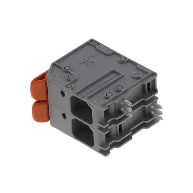

Datasheet Wago 2616-1102/020-000 — Даташит
Клеммная колодка для печатной платы; рычаг; 16 мм²; Шаг контактов 10 мм; 2-полюсный; Зажим Push-in CAGE CLAMP

Actuating element color | orange |
Actuation type | Lever |
Clamping spring material | Chrome nickel spring steel (CrNi) |
Цвет | gray |
Connection technology | Push-in CAGE CLAMP® |
Contact material | Electrolytic copper (Ecu) |
Contact plating | tin-plated |
Country of origin | DE |
Габариты: глубина | 32 mm / 1.26 inch |
Drilled hole diameter (tolerance) | 1.7(+ 0.1) мм |
Fine-stranded conductor | 0.75 … 25 mm² / 18 … 4 AWG |
Fine-stranded conductor with ferrule with plastic collar | 0.75 … 16 mm² |
Fine-stranded conductor with ferrule without plastic collar | 0.75 … 16 mm² |
Fine-stranded conductor, with twin ferrule | 0.75 … 6 mm² |
GTIN | 4055143707350 |
Height | 37.2 mm / 1.465 inch |
Height from the surface | 33.2 mm / 1.307 inch |
Legend (ratings) | (III / 2) ≙ Overvoltage category III / Pollution degree 2 |
Limit temperature range | -60 … +105 °C |
Material group | I |
Number of Poles | 2 |
Number of connection types | 1 |
Number of levels | 1 |
Number of solder pins per potential | 3 |
PCB contact | THT |
Packaging type | BOX |
Pin spacing | 10 mm (0.394 inch) |
Rated current | 76 A |
Rated impulse voltage (II / 2) | 8 kV |
Rated impulse voltage (III / 2) | 8 kV |
Rated impulse voltage (III / 3) | 8 kV |
Rated voltage (II / 2) | 1000 В |
Rated voltage (III / 2) | 1000 В |
Rated voltage (III / 3) | 1000 В |
Solder pin arrangement | over the entire terminal strip, staggered |
Solder pin dimensions | 1.2 x 1.2 mm |
Solder pin length | 4 мм |
Solid conductor | 0.75 … 16 mm² / 18 … 4 AWG |
Strip length | 18 … 20 mm / 0.71 … 0.79 Inch |
Total number of connection points | 2 |
Total number of potentials | 2 |
Вес | 19.097 г |
Ширина | 22.8 mm / 0.898 inch |
