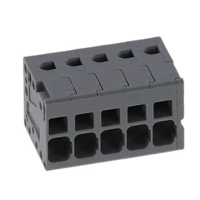

Datasheet Wago 2624-3105 — Даташит
Клеммная колодка для печатной платы; 4 мм²; Шаг контактов 5 мм; 5-полюсный; Зажим Push-in CAGE CLAMP

| Actuation type | Operating tool |
| Clamping spring material | Chrome nickel spring steel (CrNi) |
| Цвет | gray |
| Conductor entry angle to the PCB | 90 ° |
| Connection technology | Push-in CAGE CLAMP® |
| Contact material | Electrolytic copper (Ecu) |
| Contact plating | tin-plated |
| Country of origin | DE |
| Габариты: глубина | 15.4 mm / 0.606 inch |
| Drilled hole diameter (tolerance) | 1.3(+ 0.1) мм |
| Fine-stranded conductor | 0.2 … 6 mm² / 24 … 10 AWG |
| Fine-stranded conductor with ferrule with plastic collar | 0.25 … 2.5 mm² |
| Fine-stranded conductor with ferrule without plastic collar | 0.25 … 2.5 mm² |
| Fine-stranded conductor, with twin ferrule | 0.25 … 1.5 mm² |
| Flammability class per UL94 | V0 |
| GTIN | 4055143578776 |
| Height | 20.3 mm / 0.799 inch |
| Height from the surface | 16.3 mm / 0.642 inch |
| Insulating material | Polyamide 66 (PA 66) |
| Legend (ratings) | (III / 2) ≙ Overvoltage category III / Pollution degree 2 |
| Limit temperature range | -60 … +105 °C |
| Material group | I |
| Number of Poles | 5 |
| Number of connection types | 1 |
| Number of levels | 1 |
| Number of solder pins per potential | 2 |
| PCB contact | THT |
| Pin spacing | 5 mm (0.197 inch) |
| Rated current | 41 A |
| Rated impulse voltage (II / 2) | 4 kV |
| Rated impulse voltage (III / 2) | 4 kV |
| Rated impulse voltage (III / 3) | 4 kV |
| Rated voltage (II / 2) | 630 В |
| Rated voltage (III / 2) | 400 В |
| Rated voltage (III / 3) | 320 В |
| Solder pin arrangement | over the entire terminal strip, in line |
| Solder pin dimensions | 0.8 x 1 mm |
| Solder pin length | 4 мм |
| Solid conductor | 0.2 … 6 mm² / 24 … 10 AWG |
| Strip length | 10 … 12 mm / 0.39 … 0.47 Inch |
| Total number of connection points | 5 |
| Total number of potentials | 5 |
| Type of mounting | Feed-through mounting |
| Вес | 8.16 г |
| Ширина | 26.5 mm / 1.043 inch |
