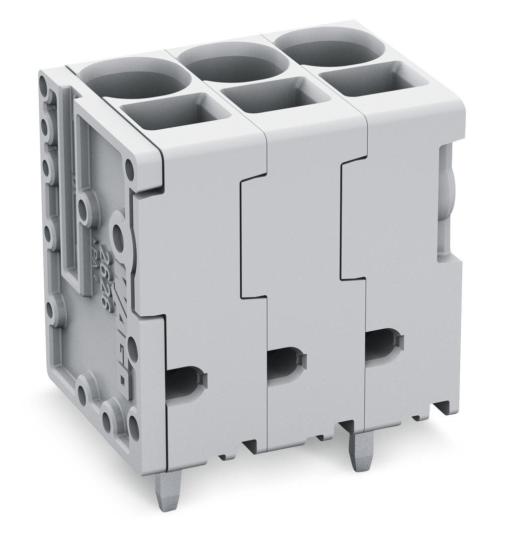

Parameters / Models | 2626-1101![]() | 2626-1102/020-000![]() | 2626-1103/020-000![]() | 2626-1103/020-004![]() | 2626-1104/020-000![]() | 2626-1104/020-004![]() | 2626-1105/020-000![]() | 2626-1105/020-004![]() | 2626-1106/020-000![]() | 2626-1107/020-000![]() | 2626-1108/020-000![]() | 2626-1109/020-000![]() | 2626-1110/020-000![]() | 2626-1111/020-000![]() | 2626-1112/020-000![]() | 2626-3101![]() | 2626-3102![]() | 2626-3102/020-000![]() | 2626-3103![]() | 2626-3103/020-000![]() | 2626-3104![]() | 2626-3104/020-000![]() | 2626-3105/020-000![]() | 2626-3105/020-004![]() | 2626-3106/020-000![]() | 2626-3107/020-000![]() | 2626-3108/020-000![]() | 2626-3109/020-000![]() | 2626-3110/020-000![]() | 2626-3111/020-000![]() | 2626-3112/020-000![]() | 2626-3452![]() |
Actuation type | Operating tool | Operating tool | Operating tool | Operating tool | Operating tool | Operating tool | Operating tool | Operating tool | Operating tool | Operating tool | Operating tool | Operating tool | Operating tool | Operating tool | Operating tool | Operating tool | Operating tool | Operating tool | Operating tool | Operating tool | Operating tool | Operating tool | Operating tool | Operating tool | Operating tool | Operating tool | Operating tool | Operating tool | Operating tool | Operating tool | Operating tool | Operating tool |
Clamping spring material | Chrome nickel spring steel (CrNi) | Chrome nickel spring steel (CrNi) | Chrome nickel spring steel (CrNi) | Chrome nickel spring steel (CrNi) | Chrome nickel spring steel (CrNi) | Chrome nickel spring steel (CrNi) | Chrome nickel spring steel (CrNi) | Chrome nickel spring steel (CrNi) | Chrome nickel spring steel (CrNi) | Chrome nickel spring steel (CrNi) | Chrome nickel spring steel (CrNi) | Chrome nickel spring steel (CrNi) | Chrome nickel spring steel (CrNi) | Chrome nickel spring steel (CrNi) | Chrome nickel spring steel (CrNi) | Chrome nickel spring steel (CrNi) | Chrome nickel spring steel (CrNi) | Chrome nickel spring steel (CrNi) | Chrome nickel spring steel (CrNi) | Chrome nickel spring steel (CrNi) | Chrome nickel spring steel (CrNi) | Chrome nickel spring steel (CrNi) | Chrome nickel spring steel (CrNi) | Chrome nickel spring steel (CrNi) | Chrome nickel spring steel (CrNi) | Chrome nickel spring steel (CrNi) | Chrome nickel spring steel (CrNi) | Chrome nickel spring steel (CrNi) | Chrome nickel spring steel (CrNi) | Chrome nickel spring steel (CrNi) | Chrome nickel spring steel (CrNi) | Chrome nickel spring steel (CrNi) |
Цвет | gray | gray | gray | black | gray | black | gray | black | gray | gray | gray | gray | gray | gray | gray | gray | gray | gray | gray | gray | gray | gray | gray | black | gray | gray | gray | gray | gray | gray | gray | gray |
Conductor entry angle to the PCB, ° | 90 | 90 | 90 | 90 | 90 | 90 | 90 | 90 | 90 | 90 | 90 | 90 | 90 | 90 | 90 | 90 | 90 | |||||||||||||||
Connection technology | Push-in CAGE CLAMP® | Push-in CAGE CLAMP® | Push-in CAGE CLAMP® | Push-in CAGE CLAMP® | Push-in CAGE CLAMP® | Push-in CAGE CLAMP® | Push-in CAGE CLAMP® | Push-in CAGE CLAMP® | Push-in CAGE CLAMP® | Push-in CAGE CLAMP® | Push-in CAGE CLAMP® | Push-in CAGE CLAMP® | Push-in CAGE CLAMP® | Push-in CAGE CLAMP® | Push-in CAGE CLAMP® | Push-in CAGE CLAMP® | Push-in CAGE CLAMP® | Push-in CAGE CLAMP® | Push-in CAGE CLAMP® | Push-in CAGE CLAMP® | Push-in CAGE CLAMP® | Push-in CAGE CLAMP® | Push-in CAGE CLAMP® | Push-in CAGE CLAMP® | Push-in CAGE CLAMP® | Push-in CAGE CLAMP® | Push-in CAGE CLAMP® | Push-in CAGE CLAMP® | Push-in CAGE CLAMP® | Push-in CAGE CLAMP® | Push-in CAGE CLAMP® | Push-in CAGE CLAMP® |
Contact material | Electrolytic copper (Ecu) | Electrolytic copper (Ecu) | Electrolytic copper (Ecu) | Electrolytic copper (Ecu) | Electrolytic copper (Ecu) | Electrolytic copper (Ecu) | Electrolytic copper (Ecu) | Electrolytic copper (Ecu) | Electrolytic copper (Ecu) | Electrolytic copper (Ecu) | Electrolytic copper (Ecu) | Electrolytic copper (Ecu) | Electrolytic copper (Ecu) | Electrolytic copper (Ecu) | Electrolytic copper (Ecu) | Electrolytic copper (Ecu) | Electrolytic copper (Ecu) | Electrolytic copper (Ecu) | Electrolytic copper (Ecu) | Electrolytic copper (Ecu) | Electrolytic copper (Ecu) | Electrolytic copper (Ecu) | Electrolytic copper (Ecu) | Electrolytic copper (Ecu) | Electrolytic copper (Ecu) | Electrolytic copper (Ecu) | Electrolytic copper (Ecu) | Electrolytic copper (Ecu) | Electrolytic copper (Ecu) | Electrolytic copper (Ecu) | Electrolytic copper (Ecu) | Electrolytic copper (Ecu) |
Contact plating | tin-plated | tin-plated | tin-plated | tin-plated | tin-plated | tin-plated | tin-plated | tin-plated | tin-plated | tin-plated | tin-plated | tin-plated | tin-plated | tin-plated | tin-plated | tin-plated | tin-plated | tin-plated | tin-plated | tin-plated | tin-plated | tin-plated | tin-plated | tin-plated | tin-plated | tin-plated | tin-plated | tin-plated | tin-plated | tin-plated | tin-plated | tin-plated |
Country of origin | DE | DE | DE | DE | DE | DE | DE | DE | DE | DE | DE | DE | DE | DE | DE | DE | DE | DE | DE | DE | DE | DE | DE | DE | DE | DE | DE | DE | DE | DE | DE | DE |
Габариты: глубина | 24.2 mm / 0.953 inch | 24.2 mm / 0.953 inch | 24.2 mm / 0.953 inch | 24.2 mm / 0.953 inch | 24.2 mm / 0.953 inch | 24.2 mm / 0.953 inch | 24.2 mm / 0.953 inch | 24.2 mm / 0.953 inch | 24.2 mm / 0.953 inch | 24.2 mm / 0.953 inch | 24.2 mm / 0.953 inch | 24.2 mm / 0.953 inch | 24.2 mm / 0.953 inch | 24.2 mm / 0.953 inch | 24.2 mm / 0.953 inch | 18.5 mm / 0.728 inch | 18.5 mm / 0.728 inch | 18.5 mm / 0.728 inch | 18.5 mm / 0.728 inch | 18.5 mm / 0.728 inch | 18.5 mm / 0.728 inch | 18.5 mm / 0.728 inch | 18.5 mm / 0.728 inch | 18.5 mm / 0.728 inch | 18.5 mm / 0.728 inch | 18.5 mm / 0.728 inch | 18.5 mm / 0.728 inch | 18.5 mm / 0.728 inch | 18.5 mm / 0.728 inch | 18.5 mm / 0.728 inch | 18.5 mm / 0.728 inch | 18.5 mm / 0.728 inch |
Drilled hole diameter (tolerance), мм | 2(+ 0.1) | 2(+ 0.1) | 2(+ 0.1) | 2(+ 0.1) | 2(+ 0.1) | 2(+ 0.1) | 2(+ 0.1) | 2(+ 0.1) | 2(+ 0.1) | 2(+ 0.1) | 2(+ 0.1) | 2(+ 0.1) | 2(+ 0.1) | 2(+ 0.1) | 2(+ 0.1) | 2(+ 0.1) | 2(+ 0.1) | 2(+ 0.1) | 2(+ 0.1) | 2(+ 0.1) | 2(+ 0.1) | 2(+ 0.1) | 2(+ 0.1) | 2(+ 0.1) | 2(+ 0.1) | 2(+ 0.1) | 2(+ 0.1) | 2(+ 0.1) | 2(+ 0.1) | 2(+ 0.1) | 2(+ 0.1) | 2(+ 0.1) |
Fine-stranded conductor | 0.2 … 10 mm² / 24 … 8 AWG | 0.2 … 10 mm² / 24 … 8 AWG | 0.2 … 10 mm² / 24 … 8 AWG | 0.2 … 10 mm² / 24 … 8 AWG | 0.2 … 10 mm² / 24 … 8 AWG | 0.2 … 10 mm² / 24 … 8 AWG | 0.2 … 10 mm² / 24 … 8 AWG | 0.2 … 10 mm² / 24 … 8 AWG | 0.2 … 10 mm² / 24 … 8 AWG | 0.2 … 10 mm² / 24 … 8 AWG | 0.2 … 10 mm² / 24 … 8 AWG | 0.2 … 10 mm² / 24 … 8 AWG | 0.2 … 10 mm² / 24 … 8 AWG | 0.2 … 10 mm² / 24 … 8 AWG | 0.2 … 10 mm² / 24 … 8 AWG | 0.2 … 10 mm² / 24 … 8 AWG | 0.2 … 10 mm² / 24 … 8 AWG | 0.2 … 10 mm² / 24 … 8 AWG | 0.2 … 10 mm² / 24 … 8 AWG | 0.2 … 10 mm² / 24 … 8 AWG | 0.2 … 10 mm² / 24 … 8 AWG | 0.2 … 10 mm² / 24 … 8 AWG | 0.2 … 10 mm² / 24 … 8 AWG | 0.2 … 10 mm² / 24 … 8 AWG | 0.2 … 10 mm² / 24 … 8 AWG | 0.2 … 10 mm² / 24 … 8 AWG | 0.2 … 10 mm² / 24 … 8 AWG | 0.2 … 10 mm² / 24 … 8 AWG | 0.2 … 10 mm² / 24 … 8 AWG | 0.2 … 10 mm² / 24 … 8 AWG | 0.2 … 10 mm² / 24 … 8 AWG | 0.2 … 10 mm² / 24 … 8 AWG |
Fine-stranded conductor with ferrule with plastic collar | 0.25 … 6 mm² | 0.25 … 6 mm² | 0.25 … 6 mm² | 0.25 … 6 mm² | 0.25 … 6 mm² | 0.25 … 6 mm² | 0.25 … 6 mm² | 0.25 … 6 mm² | 0.25 … 6 mm² | 0.25 … 6 mm² | 0.25 … 6 mm² | 0.25 … 6 mm² | 0.25 … 6 mm² | 0.25 … 6 mm² | 0.25 … 6 mm² | 0.25 … 6 mm² | 0.25 … 6 mm² | 0.25 … 6 mm² | 0.25 … 6 mm² | 0.25 … 6 mm² | 0.25 … 6 mm² | 0.25 … 6 mm² | 0.25 … 6 mm² | 0.25 … 6 mm² | 0.25 … 6 mm² | 0.25 … 6 mm² | 0.25 … 6 mm² | 0.25 … 6 mm² | 0.25 … 6 mm² | 0.25 … 6 mm² | 0.25 … 6 mm² | 0.25 … 6 mm² |
Fine-stranded conductor with ferrule without plastic collar | 0.25 … 6 mm² | 0.25 … 6 mm² | 0.25 … 6 mm² | 0.25 … 6 mm² | 0.25 … 6 mm² | 0.25 … 6 mm² | 0.25 … 6 mm² | 0.25 … 6 mm² | 0.25 … 6 mm² | 0.25 … 6 mm² | 0.25 … 6 mm² | 0.25 … 6 mm² | 0.25 … 6 mm² | 0.25 … 6 mm² | 0.25 … 6 mm² | 0.25 … 6 mm² | 0.25 … 6 mm² | 0.25 … 6 mm² | 0.25 … 6 mm² | 0.25 … 6 mm² | 0.25 … 6 mm² | 0.25 … 6 mm² | 0.25 … 6 mm² | 0.25 … 6 mm² | 0.25 … 6 mm² | 0.25 … 6 mm² | 0.25 … 6 mm² | 0.25 … 6 mm² | 0.25 … 6 mm² | 0.25 … 6 mm² | 0.25 … 6 mm² | 0.25 … 6 mm² |
Fine-stranded conductor, with twin ferrule | 0.25 … 2.5 mm² | 0.25 … 2.5 mm² | 0.25 … 2.5 mm² | 0.25 … 2.5 mm² | 0.25 … 2.5 mm² | 0.25 … 2.5 mm² | 0.25 … 2.5 mm² | 0.25 … 2.5 mm² | 0.25 … 2.5 mm² | 0.25 … 2.5 mm² | 0.25 … 2.5 mm² | 0.25 … 2.5 mm² | 0.25 … 2.5 mm² | 0.25 … 2.5 mm² | 0.25 … 2.5 mm² | 0.25 … 2.5 mm² | 0.25 … 2.5 mm² | 0.25 … 2.5 mm² | 0.25 … 2.5 mm² | 0.25 … 2.5 mm² | 0.25 … 2.5 mm² | 0.25 … 2.5 mm² | 0.25 … 2.5 mm² | 0.25 … 2.5 mm² | 0.25 … 2.5 mm² | 0.25 … 2.5 mm² | 0.25 … 2.5 mm² | 0.25 … 2.5 mm² | 0.25 … 2.5 mm² | 0.25 … 2.5 mm² | 0.25 … 2.5 mm² | 0.25 … 2.5 mm² |
Flammability class per UL94 | V0 | V0 | V0 | V0 | V0 | V0 | V0 | V0 | V0 | V0 | V0 | V0 | V0 | V0 | V0 | V0 | V0 | V0 | V0 | V0 | V0 | V0 | V0 | V0 | V0 | V0 | V0 | V0 | V0 | V0 | V0 | V0 |
GTIN | 4055143587068 | 4055143587075 | 4055143587099 | 4055143766043 | 4055143587105 | 4055143766029 | 4055143587129 | 4055143766012 | 4055143587174 | 4055143587198 | 4055143587204 | 4055143587211 | 4055143587228 | 4055143587242 | 4055143587259 | 4055143587266 | 4055143731744 | 4055143587273 | 4055143731751 | 4055143587303 | 4055143731768 | 4055143587327 | 4055143587334 | 4055143646413 | 4055143587341 | 4055143587358 | 4055143587365 | 4055143587372 | 4055143587389 | 4055143587396 | 4055143587402 | 4055143686839 |
Height | 23.6 mm / 0.929 inch | 23.6 mm / 0.929 inch | 23.6 mm / 0.929 inch | 23.6 mm / 0.929 inch | 23.6 mm / 0.929 inch | 23.6 mm / 0.929 inch | 23.6 mm / 0.929 inch | 23.6 mm / 0.929 inch | 23.6 mm / 0.929 inch | 23.6 mm / 0.929 inch | 23.6 mm / 0.929 inch | 23.6 mm / 0.929 inch | 23.6 mm / 0.929 inch | 23.6 mm / 0.929 inch | 23.6 mm / 0.929 inch | 28.2 mm / 1.11 inch | 28.2 mm / 1.11 inch | 28.2 mm / 1.11 inch | 28.2 mm / 1.11 inch | 28.2 mm / 1.11 inch | 28.2 mm / 1.11 inch | 28.2 mm / 1.11 inch | 28.2 mm / 1.11 inch | 28.2 mm / 1.11 inch | 28.2 mm / 1.11 inch | 28.2 mm / 1.11 inch | 28.2 mm / 1.11 inch | 28.2 mm / 1.11 inch | 28.2 mm / 1.11 inch | 28.2 mm / 1.11 inch | 28.2 mm / 1.11 inch | 28.2 mm / 1.11 inch |
Height from the surface | 19.6 mm / 0.772 inch | 19.6 mm / 0.772 inch | 19.6 mm / 0.772 inch | 19.6 mm / 0.772 inch | 19.6 mm / 0.772 inch | 19.6 mm / 0.772 inch | 19.6 mm / 0.772 inch | 19.6 mm / 0.772 inch | 19.6 mm / 0.772 inch | 19.6 mm / 0.772 inch | 19.6 mm / 0.772 inch | 19.6 mm / 0.772 inch | 19.6 mm / 0.772 inch | 19.6 mm / 0.772 inch | 19.6 mm / 0.772 inch | 24.2 mm / 0.953 inch | 24.2 mm / 0.953 inch | 24.2 mm / 0.953 inch | 24.2 mm / 0.953 inch | 24.2 mm / 0.953 inch | 24.2 mm / 0.953 inch | 24.2 mm / 0.953 inch | 24.2 mm / 0.953 inch | 24.2 mm / 0.953 inch | 24.2 mm / 0.953 inch | 24.2 mm / 0.953 inch | 24.2 mm / 0.953 inch | 24.2 mm / 0.953 inch | 24.2 mm / 0.953 inch | 24.2 mm / 0.953 inch | 24.2 mm / 0.953 inch | 24.2 mm / 0.953 inch |
Insulating material | Polyamide 66 (PA 66) | Polyamide 66 (PA 66) | Polyamide 66 (PA 66) | Polyamide 66 (PA 66) | Polyamide 66 (PA 66) | Polyamide 66 (PA 66) | Polyamide 66 (PA 66) | Polyamide 66 (PA 66) | Polyamide 66 (PA 66) | Polyamide 66 (PA 66) | Polyamide 66 (PA 66) | Polyamide 66 (PA 66) | Polyamide 66 (PA 66) | Polyamide 66 (PA 66) | Polyamide 66 (PA 66) | Polyamide 66 (PA 66) | Polyamide 66 (PA 66) | Polyamide 66 (PA 66) | Polyamide 66 (PA 66) | Polyamide 66 (PA 66) | Polyamide 66 (PA 66) | Polyamide 66 (PA 66) | Polyamide 66 (PA 66) | Polyamide 66 (PA 66) | Polyamide 66 (PA 66) | Polyamide 66 (PA 66) | Polyamide 66 (PA 66) | Polyamide 66 (PA 66) | Polyamide 66 (PA 66) | Polyamide 66 (PA 66) | Polyamide 66 (PA 66) | Polyamide 66 (PA 66) |
Legend (ratings) | (III / 2) ≙ Overvoltage category III / Pollution degree 2 | (III / 2) ≙ Overvoltage category III / Pollution degree 2 | (III / 2) ≙ Overvoltage category III / Pollution degree 2 | (III / 2) ≙ Overvoltage category III / Pollution degree 2 | (III / 2) ≙ Overvoltage category III / Pollution degree 2 | (III / 2) ≙ Overvoltage category III / Pollution degree 2 | (III / 2) ≙ Overvoltage category III / Pollution degree 2 | (III / 2) ≙ Overvoltage category III / Pollution degree 2 | (III / 2) ≙ Overvoltage category III / Pollution degree 2 | (III / 2) ≙ Overvoltage category III / Pollution degree 2 | (III / 2) ≙ Overvoltage category III / Pollution degree 2 | (III / 2) ≙ Overvoltage category III / Pollution degree 2 | (III / 2) ≙ Overvoltage category III / Pollution degree 2 | (III / 2) ≙ Overvoltage category III / Pollution degree 2 | (III / 2) ≙ Overvoltage category III / Pollution degree 2 | (III / 2) ≙ Overvoltage category III / Pollution degree 2 | (III / 2) ≙ Overvoltage category III / Pollution degree 2 | (III / 2) ≙ Overvoltage category III / Pollution degree 2 | (III / 2) ≙ Overvoltage category III / Pollution degree 2 | (III / 2) ≙ Overvoltage category III / Pollution degree 2 | (III / 2) ≙ Overvoltage category III / Pollution degree 2 | (III / 2) ≙ Overvoltage category III / Pollution degree 2 | (III / 2) ≙ Overvoltage category III / Pollution degree 2 | (III / 2) ≙ Overvoltage category III / Pollution degree 2 | (III / 2) ≙ Overvoltage category III / Pollution degree 2 | (III / 2) ≙ Overvoltage category III / Pollution degree 2 | (III / 2) ≙ Overvoltage category III / Pollution degree 2 | (III / 2) ≙ Overvoltage category III / Pollution degree 2 | (III / 2) ≙ Overvoltage category III / Pollution degree 2 | (III / 2) ≙ Overvoltage category III / Pollution degree 2 | (III / 2) ≙ Overvoltage category III / Pollution degree 2 | (III / 2) ≙ Overvoltage category III / Pollution degree 2 |
Limit temperature range | -60 … +105 °C | -60 … +105 °C | -60 … +105 °C | -60 … +105 °C | -60 … +105 °C | -60 … +105 °C | -60 … +105 °C | -60 … +105 °C | -60 … +105 °C | -60 … +105 °C | -60 … +105 °C | -60 … +105 °C | -60 … +105 °C | -60 … +105 °C | -60 … +105 °C | -60 … +105 °C | -60 … +105 °C | -60 … +105 °C | -60 … +105 °C | -60 … +105 °C | -60 … +105 °C | -60 … +105 °C | -60 … +105 °C | -60 … +105 °C | -60 … +105 °C | -60 … +105 °C | -60 … +105 °C | -60 … +105 °C | -60 … +105 °C | -60 … +105 °C | -60 … +105 °C | -60 … +105 °C |
Material group | I | I | I | I | I | I | I | I | I | I | I | I | I | I | I | I | I | I | I | I | I | I | I | I | I | I | I | I | I | I | I | I |
Number of Poles | 1 | 2 | 3 | 3 | 4 | 4 | 5 | 5 | 6 | 7 | 8 | 9 | 10 | 11 | 12 | 1 | 2 | 2 | 3 | 3 | 4 | 4 | 5 | 5 | 6 | 7 | 8 | 9 | 10 | 11 | 12 | 2 |
Number of connection types | 1 | 1 | 1 | 1 | 1 | 1 | 1 | 1 | 1 | 1 | 1 | 1 | 1 | 1 | 1 | 1 | 1 | 1 | 1 | 1 | 1 | 1 | 1 | 1 | 1 | 1 | 1 | 1 | 1 | 1 | 1 | 1 |
Number of levels | 1 | 1 | 1 | 1 | 1 | 1 | 1 | 1 | 1 | 1 | 1 | 1 | 1 | 1 | 1 | 1 | 1 | 1 | 1 | 1 | 1 | 1 | 1 | 1 | 1 | 1 | 1 | 1 | 1 | 1 | 1 | 1 |
Number of solder pins per potential | 1 | 1 | 1 | 1 | 1 | 1 | 1 | 1 | 1 | 1 | 1 | 1 | 1 | 1 | 1 | 2 | 2 | 1 | 2 | 1 | 2 | 1 | 1 | 1 | 1 | 1 | 1 | 1 | 1 | 1 | 1 | 1 |
PCB contact | THT | THT | THT | THT | THT | THT | THT | THT | THT | THT | THT | THT | THT | THT | THT | THT | THT | THT | THT | THT | THT | THT | THT | THT | THT | THT | THT | THT | THT | THT | THT | THT |
Packaging type | BOX | BOX | BOX | BOX | BOX | BOX | BOX | |||||||||||||||||||||||||
Pin spacing | 7.5 mm (0.295 inch) | 7.5 mm (0.295 inch) | 7.5 mm (0.295 inch) | 7.5 mm (0.295 inch) | 7.5 mm (0.295 inch) | 7.5 mm (0.295 inch) | 7.5 mm (0.295 inch) | 7.5 mm (0.295 inch) | 7.5 mm (0.295 inch) | 7.5 mm (0.295 inch) | 7.5 mm (0.295 inch) | 7.5 mm (0.295 inch) | 7.5 mm (0.295 inch) | 7.5 mm (0.295 inch) | 7.5 mm (0.295 inch) | 7.5 mm (0.295 inch) | 7.5 mm (0.295 inch) | 7.5 mm (0.295 inch) | 7.5 mm (0.295 inch) | 7.5 mm (0.295 inch) | 7.5 mm (0.295 inch) | 7.5 mm (0.295 inch) | 7.5 mm (0.295 inch) | 7.5 mm (0.295 inch) | 7.5 mm (0.295 inch) | 7.5 mm (0.295 inch) | 7.5 mm (0.295 inch) | 7.5 mm (0.295 inch) | 7.5 mm (0.295 inch) | 7.5 mm (0.295 inch) | 7.5 mm (0.295 inch) | 7.5 mm (0.295 inch) |
Rated current, A | 41 | 41 | 41 | 41 | 41 | 41 | 41 | 41 | 41 | 41 | 41 | 41 | 41 | 41 | 41 | 41 | 41 | 41 | 41 | 41 | 41 | 41 | 41 | 41 | 41 | 41 | 41 | 41 | 41 | 41 | 41 | 41 |
Rated impulse voltage (II / 2), kV | 8 | 8 | 8 | 8 | 8 | 8 | 8 | 8 | 8 | 8 | 8 | 8 | 8 | 8 | 8 | 8 | 6 | 8 | 6 | 8 | 6 | 8 | 8 | 8 | 8 | 8 | 8 | 8 | 8 | 8 | 8 | 8 |
Rated impulse voltage (III / 2), kV | 8 | 8 | 8 | 8 | 8 | 8 | 8 | 8 | 8 | 8 | 8 | 8 | 8 | 8 | 8 | 8 | 6 | 8 | 6 | 8 | 6 | 8 | 8 | 8 | 8 | 8 | 8 | 8 | 8 | 8 | 8 | 8 |
Rated impulse voltage (III / 3), kV | 8 | 8 | 8 | 8 | 8 | 8 | 8 | 8 | 8 | 8 | 8 | 8 | 8 | 8 | 8 | 8 | 6 | 8 | 6 | 8 | 6 | 8 | 8 | 8 | 8 | 8 | 8 | 8 | 8 | 8 | 8 | 8 |
Rated voltage (II / 2), В | 1000 | 1000 | 1000 | 1000 | 1000 | 1000 | 1000 | 1000 | 1000 | 1000 | 1000 | 1000 | 1000 | 1000 | 1000 | 1000 | 1000 | 1000 | 1000 | 1000 | 1000 | 1000 | 1000 | 1000 | 1000 | 1000 | 1000 | 1000 | 1000 | 1000 | 1000 | 1000 |
Rated voltage (III / 2), В | 1000 | 1000 | 1000 | 1000 | 1000 | 1000 | 1000 | 1000 | 1000 | 1000 | 1000 | 1000 | 1000 | 1000 | 1000 | 1000 | 630 | 1000 | 630 | 1000 | 630 | 1000 | 1000 | 1000 | 1000 | 1000 | 1000 | 1000 | 1000 | 1000 | 1000 | 1000 |
Rated voltage (III / 3), В | 800 | 800 | 800 | 800 | 800 | 800 | 800 | 800 | 800 | 800 | 800 | 800 | 800 | 800 | 800 | 800 | 630 | 800 | 630 | 800 | 630 | 800 | 800 | 800 | 800 | 800 | 800 | 800 | 800 | 800 | 800 | 1000 |
Solder pin arrangement | within the terminal block, in line | over the entire terminal strip, staggered | over the entire terminal strip, staggered | over the entire terminal strip, staggered | over the entire terminal strip, staggered | over the entire terminal strip, staggered | over the entire terminal strip, staggered | over the entire terminal strip, staggered | over the entire terminal strip, staggered | over the entire terminal strip, staggered | over the entire terminal strip, staggered | over the entire terminal strip, staggered | over the entire terminal strip, staggered | over the entire terminal strip, staggered | over the entire terminal strip, staggered | within the terminal block, in line | over the entire terminal strip, in line | over the entire terminal strip, staggered | over the entire terminal strip, in line | over the entire terminal strip, staggered | over the entire terminal strip, in line | over the entire terminal strip, staggered | over the entire terminal strip, staggered | over the entire terminal strip, staggered | over the entire terminal strip, staggered | over the entire terminal strip, staggered | over the entire terminal strip, staggered | over the entire terminal strip, staggered | over the entire terminal strip, staggered | over the entire terminal strip, staggered | over the entire terminal strip, staggered | over the entire terminal strip, in line |
Solder pin dimensions | 1.5 x 1 mm | 1.5 x 1 mm | 1.5 x 1 mm | 1.5 x 1 mm | 1.5 x 1 mm | 1.5 x 1 mm | 1.5 x 1 mm | 1.5 x 1 mm | 1.5 x 1 mm | 1.5 x 1 mm | 1.5 x 1 mm | 1.5 x 1 mm | 1.5 x 1 mm | 1.5 x 1 mm | 1.5 x 1 mm | 1.5 x 1 mm | 1.5 x 1 mm | 1.5 x 1 mm | 1.5 x 1 mm | 1.5 x 1 mm | 1.5 x 1 mm | 1.5 x 1 mm | 1.5 x 1 mm | 1.5 x 1 mm | 1.5 x 1 mm | 1.5 x 1 mm | 1.5 x 1 mm | 1.5 x 1 mm | 1.5 x 1 mm | 1.5 x 1 mm | 1.5 x 1 mm | 1.5 x 1 mm |
Solder pin length, мм | 4 | 4 | 4 | 4 | 4 | 4 | 4 | 4 | 4 | 4 | 4 | 4 | 4 | 4 | 4 | 4 | 4 | 4 | 4 | 4 | 4 | 4 | 4 | 4 | 4 | 4 | 4 | 4 | 4 | 4 | 4 | 4 |
Solid conductor | 0.2 … 10 mm² / 24 … 8 AWG | 0.2 … 10 mm² / 24 … 8 AWG | 0.2 … 10 mm² / 24 … 8 AWG | 0.2 … 10 mm² / 24 … 8 AWG | 0.2 … 10 mm² / 24 … 8 AWG | 0.2 … 10 mm² / 24 … 8 AWG | 0.2 … 10 mm² / 24 … 8 AWG | 0.2 … 10 mm² / 24 … 8 AWG | 0.2 … 10 mm² / 24 … 8 AWG | 0.2 … 10 mm² / 24 … 8 AWG | 0.2 … 10 mm² / 24 … 8 AWG | 0.2 … 10 mm² / 24 … 8 AWG | 0.2 … 10 mm² / 24 … 8 AWG | 0.2 … 10 mm² / 24 … 8 AWG | 0.2 … 10 mm² / 24 … 8 AWG | 0.2 … 10 mm² / 24 … 8 AWG | 0.2 … 10 mm² / 24 … 8 AWG | 0.2 … 10 mm² / 24 … 8 AWG | 0.2 … 10 mm² / 24 … 8 AWG | 0.2 … 10 mm² / 24 … 8 AWG | 0.2 … 10 mm² / 24 … 8 AWG | 0.2 … 10 mm² / 24 … 8 AWG | 0.2 … 10 mm² / 24 … 8 AWG | 0.2 … 10 mm² / 24 … 8 AWG | 0.2 … 10 mm² / 24 … 8 AWG | 0.2 … 10 mm² / 24 … 8 AWG | 0.2 … 10 mm² / 24 … 8 AWG | 0.2 … 10 mm² / 24 … 8 AWG | 0.2 … 10 mm² / 24 … 8 AWG | 0.2 … 10 mm² / 24 … 8 AWG | 0.2 … 10 mm² / 24 … 8 AWG | 0.2 … 10 mm² / 24 … 8 AWG |
Strip length | 13 … 15 mm / 0.51 … 0.59 Inch | 13 … 15 mm / 0.51 … 0.59 Inch | 13 … 15 mm / 0.51 … 0.59 Inch | 13 … 15 mm / 0.51 … 0.59 Inch | 13 … 15 mm / 0.51 … 0.59 Inch | 13 … 15 mm / 0.51 … 0.59 Inch | 13 … 15 mm / 0.51 … 0.59 Inch | 13 … 15 mm / 0.51 … 0.59 Inch | 13 … 15 mm / 0.51 … 0.59 Inch | 13 … 15 mm / 0.51 … 0.59 Inch | 13 … 15 mm / 0.51 … 0.59 Inch | 13 … 15 mm / 0.51 … 0.59 Inch | 13 … 15 mm / 0.51 … 0.59 Inch | 13 … 15 mm / 0.51 … 0.59 Inch | 13 … 15 mm / 0.51 … 0.59 Inch | 13 … 15 mm / 0.51 … 0.59 Inch | 13 … 15 mm / 0.51 … 0.59 Inch | 13 … 15 mm / 0.51 … 0.59 Inch | 13 … 15 mm / 0.51 … 0.59 Inch | 13 … 15 mm / 0.51 … 0.59 Inch | 13 … 15 mm / 0.51 … 0.59 Inch | 13 … 15 mm / 0.51 … 0.59 Inch | 13 … 15 mm / 0.51 … 0.59 Inch | 13 … 15 mm / 0.51 … 0.59 Inch | 13 … 15 mm / 0.51 … 0.59 Inch | 13 … 15 mm / 0.51 … 0.59 Inch | 13 … 15 mm / 0.51 … 0.59 Inch | 13 … 15 mm / 0.51 … 0.59 Inch | 13 … 15 mm / 0.51 … 0.59 Inch | 13 … 15 mm / 0.51 … 0.59 Inch | 13 … 15 mm / 0.51 … 0.59 Inch | 13 … 15 mm / 0.51 … 0.59 Inch |
Total number of connection points | 1 | 2 | 3 | 3 | 4 | 4 | 5 | 5 | 6 | 7 | 8 | 9 | 10 | 11 | 12 | 1 | 2 | 2 | 3 | 3 | 4 | 4 | 5 | 5 | 6 | 7 | 8 | 9 | 10 | 11 | 12 | 2 |
Total number of potentials | 1 | 2 | 3 | 3 | 4 | 4 | 5 | 5 | 6 | 7 | 8 | 9 | 10 | 11 | 12 | 1 | 2 | 2 | 3 | 3 | 4 | 4 | 5 | 5 | 6 | 7 | 8 | 9 | 10 | 11 | 12 | 2 |
Type of mounting | Feed-through mounting | Feed-through mounting | Feed-through mounting | Feed-through mounting | Feed-through mounting | Feed-through mounting | Feed-through mounting | Feed-through mounting | Feed-through mounting | Feed-through mounting | Feed-through mounting | Feed-through mounting | Feed-through mounting | Feed-through mounting | Feed-through mounting | Feed-through mounting | Feed-through mounting | Feed-through mounting | Feed-through mounting | Feed-through mounting | Feed-through mounting | Feed-through mounting | Feed-through mounting | Feed-through mounting | Feed-through mounting | Feed-through mounting | Feed-through mounting | Feed-through mounting | Feed-through mounting | Feed-through mounting | Feed-through mounting | Feed-through mounting |
Вес, г | 4.634 | 8.288 | 12.142 | 12.142 | 15.936 | 15.936 | 19.79 | 19.79 | 23.584 | 27.438 | 31.232 | 35.086 | 38.88 | 42.734 | 46.528 | 4.514 | 8.428 | 8.038 | 12.342 | 11.742 | 16.256 | 15.476 | 19.18 | 19.18 | 22.914 | 26.618 | 30.352 | 34.056 | 37.79 | 41.494 | 45.228 | 10.648 |
Ширина | 9.3 mm / 0.366 inch | 16.8 mm / 0.661 inch | 24.3 mm / 0.957 inch | 24.3 mm / 0.957 inch | 31.8 mm / 1.252 inch | 31.8 mm / 1.252 inch | 39.3 mm / 1.547 inch | 39.3 mm / 1.547 inch | 46.8 mm / 1.843 inch | 54.3 mm / 2.138 inch | 61.8 mm / 2.433 inch | 69.3 mm / 2.728 inch | 76.8 mm / 3.024 inch | 84.3 mm / 3.319 inch | 91.8 mm / 3.614 inch | 9.3 mm / 0.366 inch | 16.8 mm / 0.661 inch | 16.8 mm / 0.661 inch | 24.3 mm / 0.957 inch | 24.3 mm / 0.957 inch | 31.8 mm / 1.252 inch | 31.8 mm / 1.252 inch | 39.3 mm / 1.547 inch | 39.3 mm / 1.547 inch | 46.8 mm / 1.843 inch | 54.3 mm / 2.138 inch | 61.8 mm / 2.433 inch | 69.3 mm / 2.728 inch | 76.8 mm / 3.024 inch | 84.3 mm / 3.319 inch | 91.8 mm / 3.614 inch | 16.8 mm / 0.661 inch |
