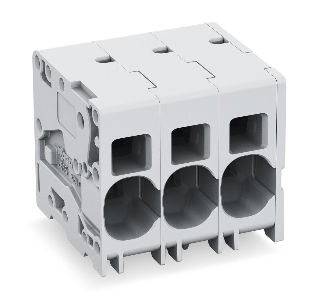

Клеммная колодка для печатной платы; 16 мм²; Шаг контактов 10 мм; 5-полюсный; Зажим Push-in CAGE CLAMP

| Actuation type | Operating tool |
| Clamping spring material | Chrome nickel spring steel (CrNi) |
| Цвет | black |
| Connection technology | Push-in CAGE CLAMP® |
| Contact material | Electrolytic copper (Ecu) |
| Contact plating | tin-plated |
| Country of origin | DE |
| Габариты: глубина | 29.1 mm / 1.146 inch |
| Drilled hole diameter (tolerance) | 1.7(+ 0.1) мм |
| Fine-stranded conductor | 0.75 … 25 mm² / 18 … 4 AWG |
| Fine-stranded conductor with ferrule with plastic collar | 0.75 … 16 mm² |
| Fine-stranded conductor with ferrule without plastic collar | 0.75 … 16 mm² |
| Fine-stranded conductor, with twin ferrule | 0.75 … 6 mm² |
| Flammability class per UL94 | V0 |
| GTIN | 4055143765985 |
| Height | 32.6 mm / 1.283 inch |
| Height from the surface | 28.6 mm / 1.126 inch |
| Insulating material | Polyamide 66 (PA 66) |
| Legend (ratings) | (III / 2) ≙ Overvoltage category III / Pollution degree 2 |
| Limit temperature range | -60 … +105 °C |
| Material group | I |
| Number of Poles | 5 |
| Number of connection types | 1 |
| Number of levels | 1 |
| Number of solder pins per potential | 3 |
| PCB contact | THT |
| Packaging type | BOX |
| Pin spacing | 10 mm (0.394 inch) |
| Rated current | 76 A |
| Rated impulse voltage (II / 2) | 8 kV |
| Rated impulse voltage (III / 2) | 8 kV |
| Rated impulse voltage (III / 3) | 8 kV |
| Rated voltage (II / 2) | 1000 В |
| Rated voltage (III / 2) | 1000 В |
| Rated voltage (III / 3) | 1000 В |
| Solder pin arrangement | over the entire terminal strip, staggered |
| Solder pin dimensions | 1.2 x 1 mm |
| Solder pin length | 4 мм |
| Solid conductor | 0.75 … 16 mm² / 18 … 4 AWG |
| Strip length | 18 … 20 mm / 0.71 … 0.79 Inch |
| Total number of connection points | 5 |
| Total number of potentials | 5 |
| Type of mounting | Feed-through mounting |
| Вес | 41.93 г |
| Ширина | 51.6 mm / 2.031 inch |
