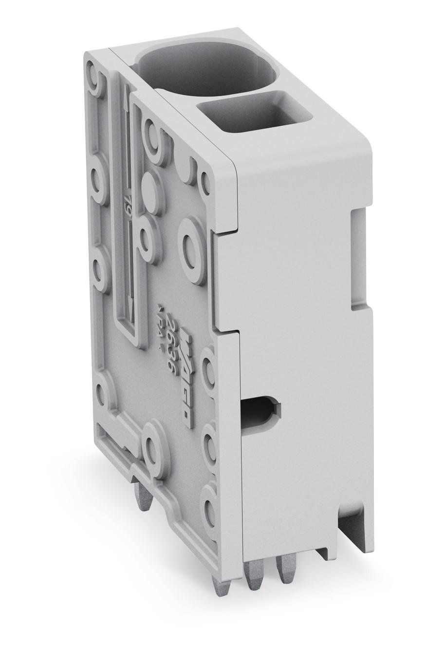

Клеммная колодка для печатной платы; 16 мм²; Шаг контактов 10 мм; 1-полюсный; Зажим Push-in CAGE CLAMP
PCB TERMINAL BLOCK; 16 MM; PIN S | |||
2636-3101/000-050 Wago | по запросу |
Actuation type | Operating tool |
Clamping spring material | Chrome nickel spring steel (CrNi) |
Цвет | gray |
Conductor entry angle to the PCB | 90 ° |
Connection technology | Push-in CAGE CLAMP® |
Contact material | Electrolytic copper (Ecu) |
Contact plating | tin-plated |
Country of origin | DE |
Габариты: глубина | 24.8 mm / 0.976 inch |
Drilled hole diameter (tolerance) | 1.7(+ 0.1) мм |
Fine-stranded conductor | 0.75 … 25 mm² / 18 … 4 AWG |
Fine-stranded conductor with ferrule with plastic collar | 0.75 … 16 mm² |
Fine-stranded conductor with ferrule without plastic collar | 0.75 … 16 mm² |
Fine-stranded conductor, with twin ferrule | 0.75 … 6 mm² |
GTIN | 4055143625470 |
Height | 35.3 mm / 1.39 inch |
Height from the surface | 31.3 mm / 1.232 inch |
Legend (ratings) | (III / 2) ≙ Overvoltage category III / Pollution degree 2 |
Limit temperature range | -60 … +105 °C |
Material group | I |
Number of Poles | 1 |
Number of connection types | 1 |
Number of levels | 1 |
Number of solder pins per potential | 3 |
PCB contact | THT |
Pin spacing | 10 mm (0.394 inch) |
Rated current | 76 A |
Rated impulse voltage (II / 2) | 8 kV |
Rated impulse voltage (III / 2) | 8 kV |
Rated impulse voltage (III / 3) | 8 kV |
Rated voltage (II / 2) | 1000 В |
Rated voltage (III / 2) | 1000 В |
Rated voltage (III / 3) | 1000 В |
Solder pin arrangement | within the terminal block, in line |
Solder pin dimensions | 1.2 x 1 mm |
Solder pin length | 4 мм |
Solid conductor | 0.75 … 16 mm² / 18 … 4 AWG |
Strip length | 18 … 20 mm / 0.71 … 0.79 Inch |
Total number of connection points | 1 |
Total number of potentials | 1 |
Type of mounting | Feed-through mounting |
Вес | 9.284 г |
Ширина | 11.6 mm / 0.457 inch |
