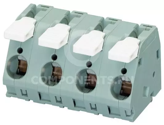

Datasheet Wago 2716-202 — Даташит
ПроизводительWago
Серия2716
Модель2716-202
Клеммная колодка для печатной платы; рычаг; 16 мм²; Шаг контактов 15 мм; 2-полюсный; CAGE CLAMP

Actuation typeLever
Clamping spring materialChrome nickel spring steel (CrNi)
Цветgray
Conductor entry angle to the PCB30 °
Connection technologyCAGE CLAMP®
Contact materialElectrolytic copper (Ecu)
Contact platingtin-plated
Country of originPL
Габариты: глубина30 mm / 1.181 inch
Drilled hole diameter (tolerance)1.6(+ 0.1) мм
Fine-stranded conductor1.5 … 16 mm² / 16 … 6 AWG
Fine-stranded conductor with ferrule with plastic collar1.5 … 10 mm²
Fine-stranded conductor with ferrule without plastic collar1.5 … 10 mm²
Fire load0.365 MJ
Flammability class per UL94V0
GTIN4045454739416
Height33.3 mm / 1.311 inch
Height from the surface28.8 mm / 1.134 inch
Insulating materialPolyamide 66 (PA 66)
Legend (ratings)(III / 2) ≙ Overvoltage category III / Pollution degree 2
Limit temperature range-60 … +105 °C
Material groupI
Number of Poles2
Number of connection types1
Number of levels1
Number of solder pins per potential4
PCB contactTHT
Pin spacing15 mm (0.591 inch)
Product Group4 (Printed Circuit)
Rated current76 A
Rated impulse voltage (II / 2)8 kV
Rated impulse voltage (III / 2)8 kV
Rated impulse voltage (III / 3)8 kV
Rated voltage (II / 2)1000 В
Rated voltage (III / 2)1000 В
Rated voltage (III / 3)800 В
Solder pin arrangementover the entire terminal strip, in line
Solder pin dimensions0.95 x 1.2 mm
Solder pin length4.5 мм
Solid conductor1.5 … 16 mm² / 16 … 6 AWG
Strip length12 … 13 mm / 0.47 … 0.51 Inch
Total number of connection points2
Total number of potentials2
Вес19.96 г
Ширина26.5 mm / 1.043 inch
