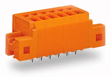

Datasheet Wago 739-340/100-000/001-000 — Даташит
PressIn-Leiterplattenklemme; 1,5 мм²; Растровая масса 3,81 мм; 10-полиг; ЗАЖИМ ДЛЯ КЛЕТКИ; Befestigungflansch
Actuation type | Operating tool |
Clamping spring material | Chrome nickel spring steel (CrNi) |
Цвет | orange |
Conductor entry angle to the PCB | 90 ° |
Connection technology | CAGE CLAMP® |
Contact material | Copper alloy |
Contact plating | tin-plated |
Габариты: глубина | 13.4 mm / 0.528 inch |
Fine-stranded conductor | 0.08 … 1.5 mm² / 28 … 14 AWG |
Fine-stranded conductor with ferrule with plastic collar | 0.25 … 1 mm² |
Fine-stranded conductor with ferrule without plastic collar | 0.25 … 1.5 mm² |
Height | 15.4 mm / 0.606 inch |
Height from the surface | 12.3 mm / 0.484 inch |
Legend (ratings) | (III / 2) ≙ Overvoltage category III / Pollution degree 2 |
Limit temperature range | -40 … +85 °C |
Material group | I |
Mounting type | Mounting flange |
Number of Poles | 10 |
Number of connection types | 1 |
Number of levels | 1 |
PCB contact | PressIn |
Pin spacing | 3.81 mm (0.15 inch) |
Press-in pin: Length | 3.1 мм |
PressIn pin: Dimensions | 0.6 x 1.2 мм |
PressIn pin: Drilled hole diameter | 1.15(+ 0.03 ... - 0.03) мм |
PressIn pin: Plated through-hole diameter (Chem. Sn) | 1(+ 0.09 ... - 0) мм |
PressIn pin: Plated through-hole diameter (HAL Sn) | 1(+ 0.09 ... - 0.06) мм |
Product Group | 4 (Printed Circuit) |
Rated current | 4 A |
Rated impulse voltage (II / 2) | 2.5 kV |
Rated impulse voltage (III / 2) | 2.5 kV |
Rated impulse voltage (III / 3) | 2.5 kV |
Rated voltage (II / 2) | 320 В |
Rated voltage (III / 2) | 160 В |
Rated voltage (III / 3) | 160 В |
Solid conductor | 0.08 … 1.5 mm² / 28 … 14 AWG |
Strip length | 5 … 6 mm / 0.2 … 0.24 Inch |
Total number of connection points | 10 |
Total number of potentials | 10 |
Type of mounting | Panel mounting |
Ширина | 52.9 mm / 2.083 inch |
