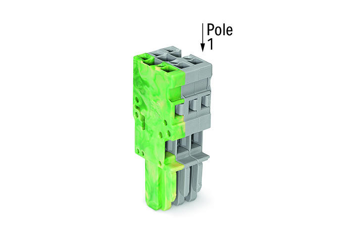

Datasheet Wago 769-102/000-037 — Даташит
1-проводниковая розетка; 4 mm²; 2-пол.
1-CONDUCTOR FEMALE PLUG; 4 MM; 2 | |||
769-102/000-037 Wago | по запросу |
Actuation type | Operating tool |
Цвет | green-yellow, gray |
Connectable conductor materials | Copper Aluminum |
Connection technology | CAGE CLAMP® |
Connector connection type | for conductors |
Contact type (pluggable connector) | Female connector/socket |
Country of origin | DE |
Габариты: глубина | 18.3 mm / 0.72 inch |
Fine-stranded conductor | 0.08 … 4 mm² / 28 … 12 AWG |
Fire load | 0.108 MJ |
GTIN | 4045454701192 |
Height | 45.2 mm / 1.78 inch |
Legend (ratings) | (III / 3) ≙ Overvoltage category III / Pollution degree 3 |
Marking level | Side marking |
Nominal cross section | 4 mm² |
Number of Poles | 2 |
Rated current | 32 A |
Rated impulse voltage (III / 3) | 6 kV |
Rated voltage (III / 3) | 500 В |
Solid conductor | 0.08 … 4 mm² / 28 … 12 AWG |
Strip length | 8 … 9 mm / 0.31 … 0.35 Inch |
Total number of connection points | 2 |
Total number of potentials | 2 |
Type of wiring | Front-entry wiring |
Вес | 6.372 г |
Ширина | 10 mm / 0.394 inch |
