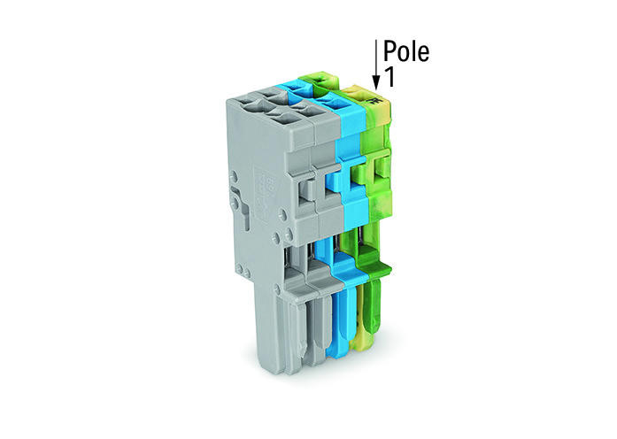

1-проводниковая розетка; 4 mm²; 4-пол.
1-CONDUCTOR FEMALE PLUG; 4 MM; 4 | |||
769-104/000-038 Wago | по запросу |
Actuation type | Operating tool |
Цвет | gray, blue, green-yellow |
Connectable conductor materials | Copper Aluminum |
Connection technology | CAGE CLAMP® |
Connector connection type | for conductors |
Contact type (pluggable connector) | Female connector/socket |
Country of origin | DE |
Габариты: глубина | 18.3 mm / 0.72 inch |
Fire load | 0.219 MJ |
GTIN | 4045454417130 |
Height | 45.2 mm / 1.78 inch |
Legend (ratings) | (III / 3) ≙ Overvoltage category III / Pollution degree 3 |
Marking level | Side marking |
Number of Poles | 4 |
Rated current | 32 A |
Rated impulse voltage (III / 3) | 6 kV |
Rated voltage (III / 3) | 500 В |
Strip length | 8 … 9 mm / 0.31 … 0.35 Inch |
Total number of connection points | 4 |
Total number of potentials | 4 |
Type of wiring | Front-entry wiring |
Вес | 12.952 г |
Ширина | 20 mm / 0.787 inch |
