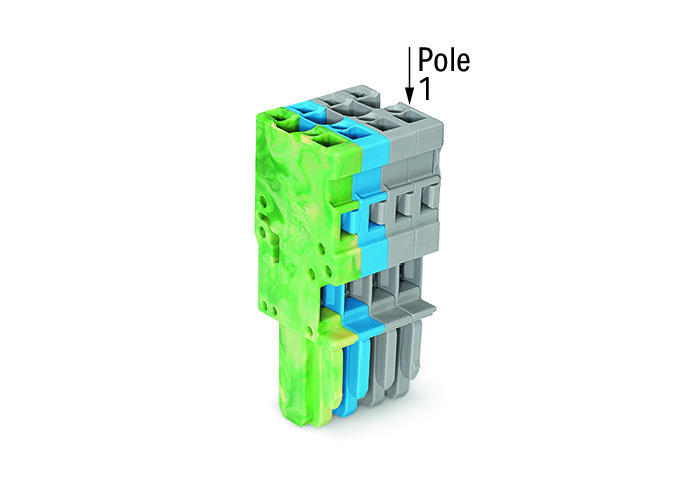

Datasheet Wago 769-104/000-039 — Даташит
ПроизводительWago
Серия769
Модель769-104/000-039
1-проводниковая розетка; 4 mm²; 4-пол.
Maybo
769-104/000-039
Wago
Wago 769-104/000-039 Wago 769-104/000-039
Actuation typeOperating tool
Цветgreen-yellow, blue, gray
Connectable conductor materialsCopper Aluminum
Connection technologyCAGE CLAMP®
Connector connection typefor conductors
Contact type (pluggable connector)Female connector/socket
Country of originDE
Габариты: глубина18.3 mm / 0.72 inch
Fire load0.218 MJ
GTIN4045454351816
Height45.2 mm / 1.78 inch
Insulating materialPolyamide 66 (PA 66)
Legend (ratings)(III / 3) ≙ Overvoltage category III / Pollution degree 3
Marking levelSide marking
Number of Poles4
Rated current32 A
Rated impulse voltage (III / 3)6 kV
Rated voltage (III / 3)500 В
Strip length8 … 9 mm / 0.31 … 0.35 Inch
Total number of connection points4
Total number of potentials4
Type of wiringFront-entry wiring
Вес12.902 г
Ширина20 mm / 0.787 inch
