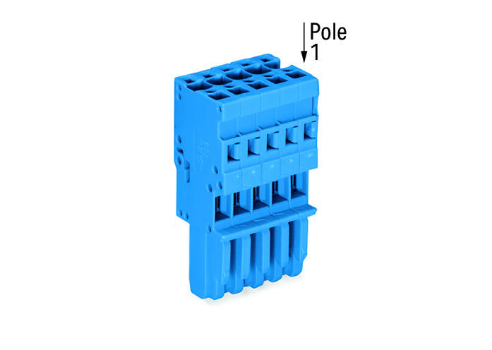

1-проводниковая розетка; 4 mm²; 5-пол.
Augswan
769-105/000-006
Wago
Wago 769-105/000-006 Wago 769-105/000-006
Actuation typeOperating tool
Цветblue
Connectable conductor materialsCopper Aluminum
Connection technologyCAGE CLAMP®
Connector connection typefor conductors
Contact type (pluggable connector)Female connector/socket
Country of originDE
Габариты: глубина18.3 mm / 0.72 inch
Fine-stranded conductor0.08 … 4 mm² / 28 … 12 AWG
Fire load0.28 MJ
GTIN4045454579821
Height45.2 mm / 1.78 inch
Insulating materialPolyamide 66 (PA 66)
Legend (ratings)(III / 3) ≙ Overvoltage category III / Pollution degree 3
Marking levelSide marking
Nominal cross section4 mm²
Number of Poles5
Rated current32 A
Rated impulse voltage (III / 3)6 kV
Rated voltage (III / 3)500 В
Solid conductor0.08 … 4 mm² / 28 … 12 AWG
Strip length8 … 9 mm / 0.31 … 0.35 Inch
Total number of connection points5
Total number of potentials5
Type of wiringFront-entry wiring
Вес16.265 г
Ширина25 mm / 0.984 inch
