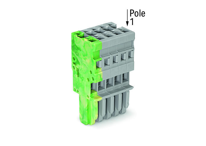

1-проводниковая розетка; 4 mm²; 5-пол.
| 1-CONDUCTOR FEMALE PLUG; 4 MM; 5 | |||
| 769-105/000-037 Wago | по запросу | ||
| Actuation type | Operating tool |
| Цвет | green-yellow, gray |
| Connectable conductor materials | Copper Aluminum |
| Connection technology | CAGE CLAMP® |
| Connector connection type | for conductors |
| Contact type (pluggable connector) | Female connector/socket |
| Country of origin | DE |
| Габариты: глубина | 18.3 mm / 0.72 inch |
| Fine-stranded conductor | 0.08 … 4 mm² / 28 … 12 AWG |
| Fire load | 0.267 MJ |
| GTIN | 4045454272302 |
| Height | 45.2 mm / 1.78 inch |
| Insulating material | Polyamide 66 (PA 66) |
| Legend (ratings) | (III / 3) ≙ Overvoltage category III / Pollution degree 3 |
| Marking level | Side marking |
| Nominal cross section | 4 mm² |
| Number of Poles | 5 |
| Rated current | 32 A |
| Rated impulse voltage (III / 3) | 6 kV |
| Rated voltage (III / 3) | 500 В |
| Solid conductor | 0.08 … 4 mm² / 28 … 12 AWG |
| Strip length | 8 … 9 mm / 0.31 … 0.35 Inch |
| Total number of connection points | 5 |
| Total number of potentials | 5 |
| Type of wiring | Front-entry wiring |
| Вес | 16.119 г |
| Ширина | 25 mm / 0.984 inch |
