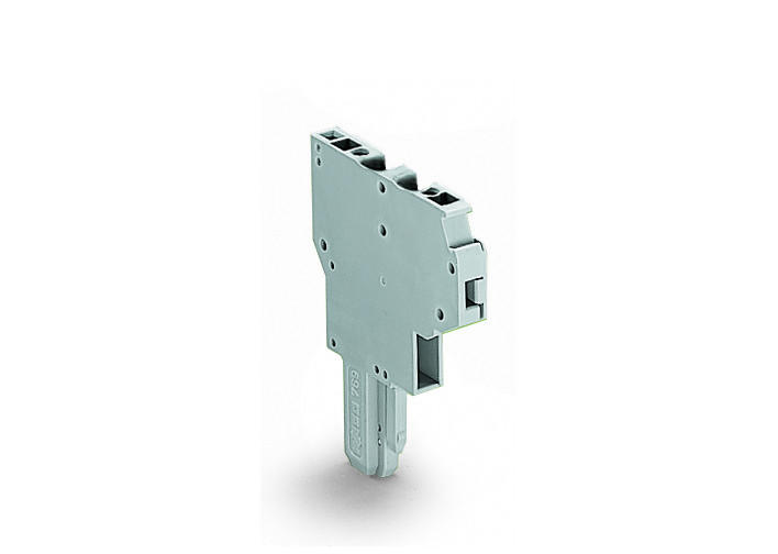

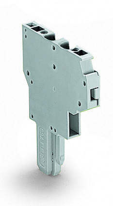

2-проводная розетка; 4 mm²; 1-пол.
769-121, 21-контакт. розетка, стандартная, серая
769-121
Wago
Оф. дистрибьютор
348 ₽
Augswan
769-121
Wago
Wago 769-121 Wago 769-121
Actuation typeOperating tool
Цветgray
Connectable conductor materialsCopper Aluminum
Connection technologyCAGE CLAMP®
Connector connection typefor conductors
Contact type (pluggable connector)Female connector/socket
Country of originPL
Габариты: глубина35.9 mm / 1.413 inch
Fine-stranded conductor0.08 … 4 mm² / 28 … 12 AWG
Fire load0.086 MJ
GTIN4044918473460
Height45.2 mm / 1.78 inch
Insulating materialPolyamide 66 (PA 66)
Legend (ratings)(III / 3) ≙ Overvoltage category III / Pollution degree 3
Marking levelSide marking
Nominal cross section4 mm²
Number of Poles1
Product Group18 (X-COM-System)
Rated current32 A
Rated impulse voltage (III / 3)6 kV
Rated voltage (III / 3)500 В
Solid conductor0.08 … 4 mm² / 28 … 12 AWG
Strip length8 … 9 mm / 0.31 … 0.35 Inch
Total number of connection points2
Total number of potentials1
Type of wiringFront-entry wiring
Вес2.88 г
Ширина5 mm / 0.197 inch
