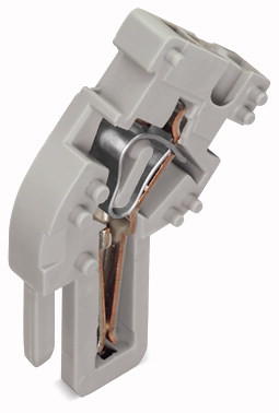

Datasheet Wago 769-515 — Даташит
1-проводной оконечный модуль; угловые; с возможностью кодирования; 1-пол.
END MODULE FOR 1-CONDUCTOR FEMAL | |||
769-515 Wago | по запросу |
Actuation type | Operating tool |
Цвет | gray |
Connectable conductor materials | Copper Aluminum |
Connection technology | CAGE CLAMP® |
Connector connection type | for conductors |
Contact type (pluggable connector) | Female connector/socket |
Country of origin | DE |
Габариты: глубина | 26.5 mm / 1.043 inch |
Fine-stranded conductor | 0.08 … 4 mm² / 28 … 12 AWG |
Fire load | 0.039 MJ |
GTIN | 4017332619738 |
Height | 37.1 mm / 1.461 inch |
Legend (ratings) | (III / 3) ≙ Overvoltage category III / Pollution degree 3 |
Marking level | Side marking |
Nominal cross section | 4 mm² |
Number of Poles | 1 |
Packaging type | bag |
Product Group | 18 (X-COM-System) |
Rated current | 32 A |
Rated impulse voltage (III / 3) | 6 kV |
Rated voltage (III / 3) | 500 В |
Solid conductor | 0.08 … 4 mm² / 28 … 12 AWG |
Strip length | 8 … 9 mm / 0.31 … 0.35 Inch |
Total number of connection points | 1 |
Total number of potentials | 1 |
Type of wiring | Front-entry wiring |
Вес | 2.308 г |
Ширина | 5 mm / 0.197 inch |
