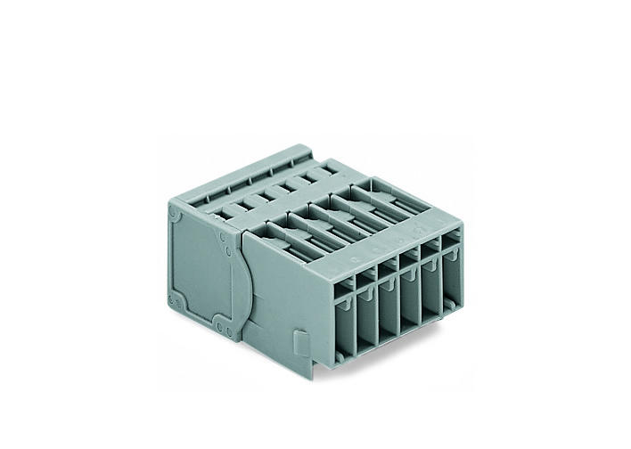

Datasheet Wago 769-602/001-000 — Даташит
1-проводная вилка; Монтажные ножки; 4 mm²; Шаг контактов 5 мм; 2-пол.
1-CONDUCTOR MALE CONNECTOR; SNAP | |||
769-602/001-000 Wago | по запросу |
Actuation type | Operating tool |
Цвет | gray |
Connectable conductor materials | Copper Aluminum |
Connection technology | CAGE CLAMP® |
Connector connection type | for conductors |
Contact type (pluggable connector) | Male connector/plug |
Country of origin | PL |
Габариты: глубина | 40.2 mm / 1.583 inch |
Fine-stranded conductor | 0.08 … 4 mm² / 28 … 12 AWG |
Fire load | 0.138 MJ |
GTIN | 4044918521932 |
Height from the surface | 18.3 mm / 0.72 inch |
Legend (ratings) | (III / 3) ≙ Overvoltage category III / Pollution degree 3 |
Mounting type | Snap-in mounting foot |
Nominal cross section | 4 mm² |
Number of Poles | 2 |
Pin spacing | 5 mm / 0.197 inch |
Product Group | 18 (X-COM-System) |
Rated current | 32 A |
Rated impulse voltage (III / 3) | 6 kV |
Rated voltage (III / 3) | 500 В |
Solid conductor | 0.08 … 4 mm² / 28 … 12 AWG |
Strip length | 8 … 9 mm / 0.31 … 0.35 Inch |
Total number of connection points | 2 |
Total number of potentials | 2 |
Type of wiring | Front-entry wiring |
Вес | 6.612 г |
Ширина | 13.6 mm / 0.535 inch |
