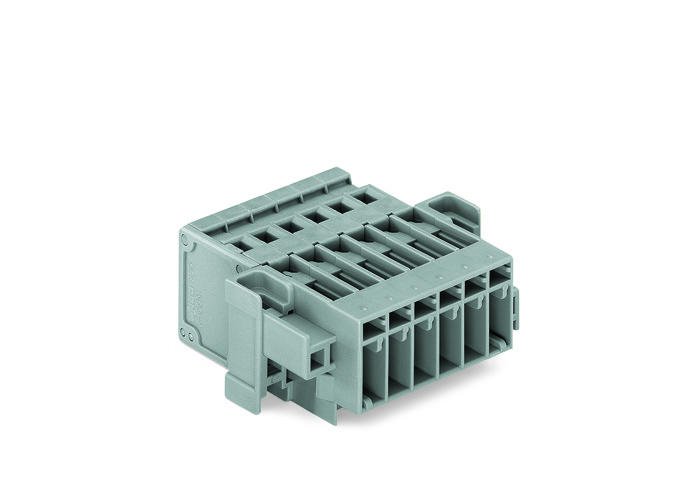

Datasheet Wago 769-602/004-000 — Даташит
1-проводная вилка; Проходной фланец; 4 mm²; Шаг контактов 5 мм; 2-пол.
| 1-CONDUCTOR MALE CONNECTOR; FEED | |||
| 769-602/004-000 Wago | 3 624 ₽ | ||
| 769-602/004-000 Wago | по запросу | ||
| Actuation type | Operating tool |
| Цвет | gray |
| Connectable conductor materials | Copper Aluminum |
| Connection technology | CAGE CLAMP® |
| Connector connection type | for conductors |
| Contact type (pluggable connector) | Male connector/plug |
| Country of origin | PL |
| Габариты: глубина | 40.2 mm / 1.583 inch |
| Fine-stranded conductor | 0.08 … 4 mm² / 28 … 12 AWG |
| Fire load | 0.18 MJ |
| GTIN | 4044918520751 |
| Height from the surface | 18.3 mm / 0.72 inch |
| Insulating material | Polyamide 66 (PA 66) |
| Legend (ratings) | (III / 3) ≙ Overvoltage category III / Pollution degree 3 |
| Mounting type | Mounting flange |
| Nominal cross section | 4 mm² |
| Number of Poles | 2 |
| Pin spacing | 5 mm / 0.197 inch |
| Product Group | 18 (X-COM-System) |
| Rated current | 32 A |
| Rated impulse voltage (III / 3) | 6 kV |
| Rated voltage (III / 3) | 500 В |
| Solid conductor | 0.08 … 4 mm² / 28 … 12 AWG |
| Strip length | 8 … 9 mm / 0.31 … 0.35 Inch |
| Total number of connection points | 2 |
| Total number of potentials | 2 |
| Type of wiring | Front-entry wiring |
| Вес | 7.938 г |
| Ширина | 24.7 mm / 0.972 inch |
