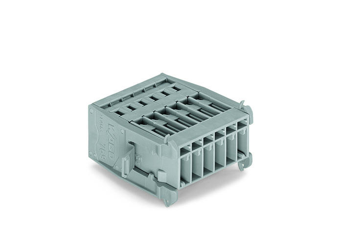

1-проводная вилка; Защелкивающийся фланец; 4 mm²; Шаг контактов 5 мм; 2-пол.
Augswan
769-602/005-000
Wago
Wago 769-602/005-000 Wago 769-602/005-000
Actuation typeOperating tool
Цветgray
Connectable conductor materialsCopper Aluminum
Connection technologyCAGE CLAMP®
Connector connection typefor conductors
Contact type (pluggable connector)Male connector/plug
Country of originPL
Габариты: глубина40.8 mm / 1.606 inch
Fine-stranded conductor0.08 … 4 mm² / 28 … 12 AWG
Fire load0.192 MJ
GTIN4044918842150
Height24.4 mm / 0.961 inch
Insulating materialPolyamide 66 (PA 66)
Legend (ratings)(III / 3) ≙ Overvoltage category III / Pollution degree 3
Mounting typeSnap-in
Nominal cross section4 mm²
Number of Poles2
Pin spacing5 mm / 0.197 inch
Product Group18 (X-COM-System)
Rated current32 A
Rated impulse voltage (III / 3)6 kV
Rated voltage (III / 3)500 В
Solid conductor0.08 … 4 mm² / 28 … 12 AWG
Strip length8 … 9 mm / 0.31 … 0.35 Inch
Total number of connection points2
Total number of potentials2
Type of wiringFront-entry wiring
Вес8.324 г
Ширина31.3 mm / 1.232 inch
