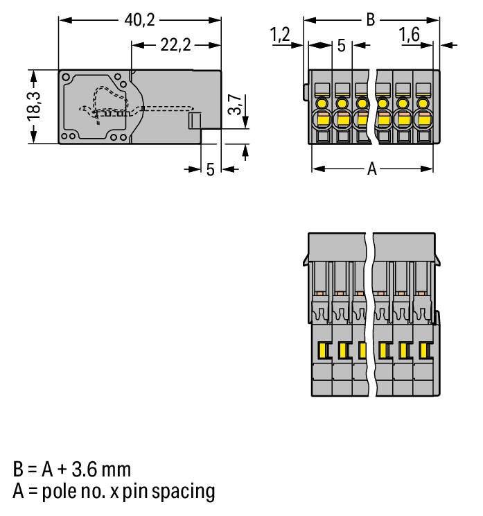

Actuation type | Operating tool |
Цвет | gray |
Connectable conductor materials | Copper Aluminum |
Connection technology | CAGE CLAMP® |
Connector connection type | for conductors |
Contact type (pluggable connector) | Male connector/plug |
Country of origin | PL |
Габариты: глубина | 40.2 mm / 1.583 inch |
Fine-stranded conductor | 0.08 … 4 mm² / 28 … 12 AWG |
Fire load | 0.579 MJ |
GTIN | 4044918521529 |
Height | 18.3 mm / 0.72 inch |
Legend (ratings) | (III / 3) ≙ Overvoltage category III / Pollution degree 3 |
Nominal cross section | 4 mm² |
Number of Poles | 10 |
Pin spacing | 5 mm / 0.197 inch |
Product Group | 18 (X-COM-System) |
Rated current | 32 A |
Rated impulse voltage (III / 3) | 6 kV |
Rated voltage (III / 3) | 500 В |
Solid conductor | 0.08 … 4 mm² / 28 … 12 AWG |
Strip length | 8 … 9 mm / 0.31 … 0.35 Inch |
Total number of connection points | 10 |
Total number of potentials | 10 |
Type of wiring | Front-entry wiring |
Вес | 28.835 г |
Ширина | 53.6 mm / 2.11 inch |
