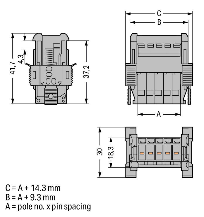

Actuation type | Operating tool |
Цвет | gray |
Connectable conductor materials | Copper Aluminum |
Connection technology | CAGE CLAMP® |
Connector connection type | for conductors |
Contact type (pluggable connector) | Male connector/plug |
Country of origin | PL |
Габариты: глубина | 41.7 mm / 1.642 inch |
Fine-stranded conductor | 0.08 … 4 mm² / 28 … 12 AWG |
Fire load | 0.838 MJ |
GTIN | 4045454917104 |
Height | 30 mm / 1.181 inch |
Legend (ratings) | (III / 3) ≙ Overvoltage category III / Pollution degree 3 |
Mounting type | Snap-in |
Nominal cross section | 4 mm² |
Number of Poles | 12 |
Pin spacing | 5 mm / 0.197 inch |
Product Group | 18 (X-COM-System) |
Rated current | 32 A |
Rated impulse voltage (III / 3) | 6 kV |
Rated voltage (III / 3) | 500 В |
Solid conductor | 0.08 … 4 mm² / 28 … 12 AWG |
Strip length | 8 … 9 mm / 0.31 … 0.35 Inch |
Total number of connection points | 12 |
Total number of potentials | 12 |
Type of wiring | Side-entry wiring |
Вес | 39.914 г |
Ширина | 74.3 mm / 2.925 inch |
