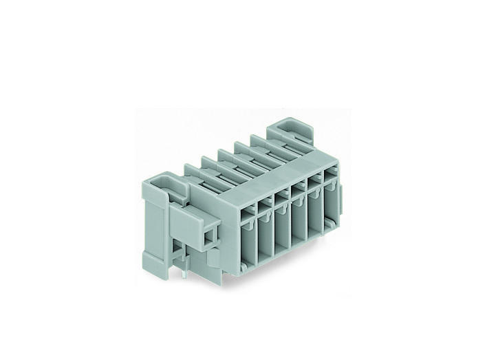

Datasheet Wago 769-662/004-000 — Даташит
Вилка THT; 1.0 x 1.0 mm solder pin; угловые; Шаг контактов 5 мм; 2-пол.
THT MALE HEADER; 1.0 X 1.0 MM SO | |||
769-662/003-000 Wago | 173 ₽ | ||
769-662/003-000 Wago | по запросу | ||
Actuation type | Operating tool |
Цвет | gray |
Connector connection type | for PCBs |
Contact type (pluggable connector) | Male connector/plug |
Country of origin | PL |
Габариты: глубина | 22.2 mm / 0.874 inch |
Fire load | 0.097 MJ |
GTIN | 4044918396530 |
Height from the surface | 18.3 mm / 0.72 inch |
Legend (ratings) | (III / 3) ≙ Overvoltage category III / Pollution degree 3 |
Mismating protection | No |
Mounting type | Mounting flange |
Number of Poles | 2 |
Number of levels | 1 |
PCB contact | THT |
Pin spacing | 5 mm / 0.197 inch |
Product Group | 18 (X-COM-System) |
Rated current | 32 A |
Rated impulse voltage (III / 2) | 4 kV |
Rated impulse voltage (III / 3) | 4 kV |
Rated voltage (III / 2) | 500 В |
Rated voltage (III / 3) | 250 В |
Solder pin dimensions | Solder pin 1 x 1 mm |
Total number of potentials | 2 |
Вес | 3.963 г |
Ширина | 24.7 mm / 0.972 inch |
Серия: 769 (100 из 460)
