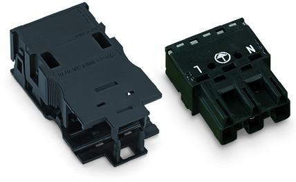

Штекер; с корпусом разгрузки натяжения; 3-пол.; Код. A
PLUG WITH STRAIN RELIEF HOUSING; | |||
770-213/035-000 Wago | по запросу |
Actuation type | Operating tool Push-in |
Clamping spring material | Chrome nickel spring steel (CrNi) |
Coding | A |
Цвет | black |
Connectable sheathed cable diameter | 7 … 11.5 mm |
Connection technology | Push-in CAGE CLAMP® |
Connector connection type | for conductors |
Contact material | Copper or copper alloy, surface-treated |
Contact type (pluggable connector) | Male connector/plug |
Country of origin | DE |
Degree of protection | IP 2xD |

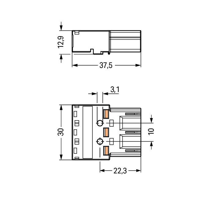

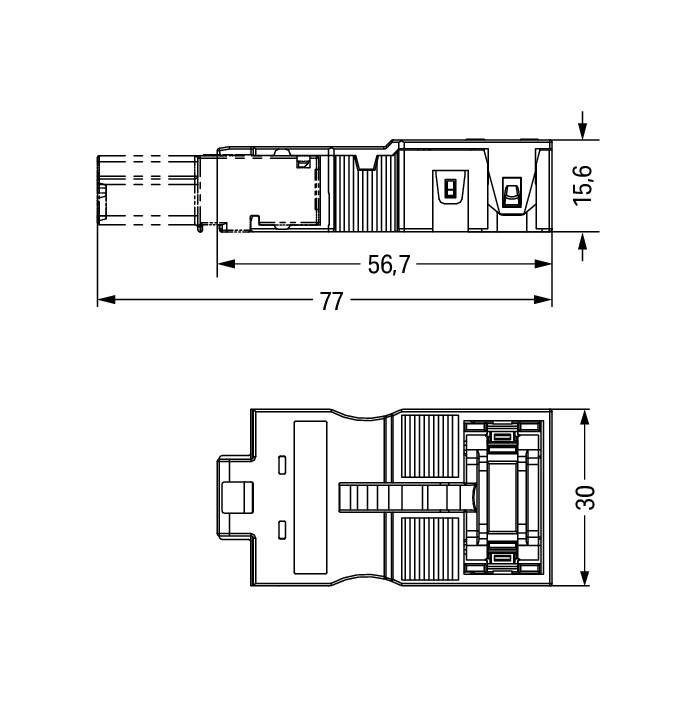

Габариты: глубина | 77 mm / 3.031 inch |
Fine-stranded conductor | 0.5 … 4 mm² / 20 … 12 AWG |
Fine-stranded conductor with ferrule with plastic collar | 0.25 … 1.5 mm² / 20 … 16 AWG |
Fine-stranded conductor with ferrule without plastic collar | 0.25 … 2.5 mm² / 20 … 14 AWG |
Fine-stranded conductor with ferrule, push-in termination, from | 1.5 mm² / 16 AWG |
Fire load | 0.44 MJ |
GTIN | 4055143209151 |
Ground function | with preceding GND contact |
Height | 15.6 mm / 0.614 inch |
Legend (ratings) | (III / 3) ≙ Overvoltage category III / Pollution degree 3 |
Locking lever | нет |
Locking of plug-in connection | locking lever |
Marking | L ⏚ N |
Mating force of a plug-in connection | approx. 20 … 70 N (depending on pole number) |
Mismating protection | Yes |
Nominal cross section | 4 mm² |
Note (strip length) | see also packaging or instructions |
Number of Poles | 3 |
Pin spacing | 10 mm (0.394 inch) |
Potential marking | L ⏚ N |
Rated current | 25 A |
Rated impulse voltage (III / 3) | 4 kV |
Rated voltage (III / 3) | 250 В |
Retention force of a plug-in connection | when locked: > 80N |
Solid conductor | 0.5 … 4 mm² / 20 … 12 AWG |
Solid conductor, push-in termination | 1.5 … 4 mm² / 16 … 12 AWG |
Strain relief color | black |
Stranded conductor | 0.5 … 2.5 mm² / 20 … 14 AWG |
Strip length | 48 мм |
Surrounding air (operating) temperature | -35 … 85 °C |
Total number of connection points | 6 |
Total number of potentials | 3 |
Unmating force of a plug-in connection | when unlocked: approx. 20 … 70 N (depending on pole number) |
Вес | 18.076 г |
Ширина | 30 mm / 1.181 inch |
