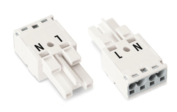

Разъем; 2-пол.; Код. A
Клеммы SCREW TERMINAL RED | |||
| 770-222 Wago | по запросу | ||
| 7702-22-NA Keystone | по запросу | ||
| Actuation type | Operating tool Push-in |
| Clamping spring material | Chrome nickel spring steel (CrNi) |
| Coding | A |
| Цвет | white |
| Connection technology | Push-in CAGE CLAMP® |
| Connector connection type | for conductors |
| Contact material | Copper or copper alloy, surface-treated |
| Contact type (pluggable connector) | Female connector/socket |
| Country of origin | DE |
| Degree of protection | IP20 |
| Габариты: глубина | 37.5 mm / 1.476 inch |
| Fine-stranded conductor | 0.5 … 4 mm² / 20 … 12 AWG |
| Fine-stranded conductor with ferrule with plastic collar | 0.25 … 1.5 mm² / 20 … 16 AWG |
| Fine-stranded conductor with ferrule without plastic collar | 0.25 … 2.5 mm² / 20 … 14 AWG |
| Fine-stranded conductor with ferrule, push-in termination, from | 1.5 mm² / 16 AWG |
| Fire load | 0.114 MJ |
| Flammability class per UL94 | V0 |
| GTIN | 4050821028130 |
| Height | 12.9 mm / 0.508 inch |
| Insulating material | Polyamide 66 (PA 66) |
| Legend (ratings) | (III / 3) ≙ Overvoltage category III / Pollution degree 3 |
| Locking lever | нет |
| Locking of plug-in connection | locking lever |
| Marking | L N |
| Mating force of a plug-in connection | approx. 20 … 70 N (depending on pole number) |
| Mismating protection | Yes |
| Nominal cross section | 4 mm² |
| Note (strip length) | see also packaging or instructions |
| Number of Poles | 2 |
| Pin spacing | 10 mm (0.394 inch) |
| Potential marking | L N |
| Product Group | 20 (WINSTA) |
| Rated current | 25 A |
| Rated impulse voltage (III / 3) | 4 kV |
| Rated voltage (III / 3) | 250 В |
| Retention force of a plug-in connection | when locked: > 80N |
| Solid conductor | 0.5 … 4 mm² / 20 … 12 AWG |
| Solid conductor, push-in termination | 1.5 … 4 mm² / 16 … 12 AWG |
| Stranded conductor | 0.5 … 2.5 mm² / 20 … 14 AWG |
| Strip length | 9 mm / 0.35 Inch |
| Surrounding air (operating) temperature | -35 … 85 °C |
| Total number of connection points | 4 |
| Total number of potentials | 2 |
| Unmating force of a plug-in connection | when unlocked: approx. 20 … 70 N (depending on pole number) |
| Вес | 6.58 г |
| Ширина | 20 mm / 0.787 inch |
