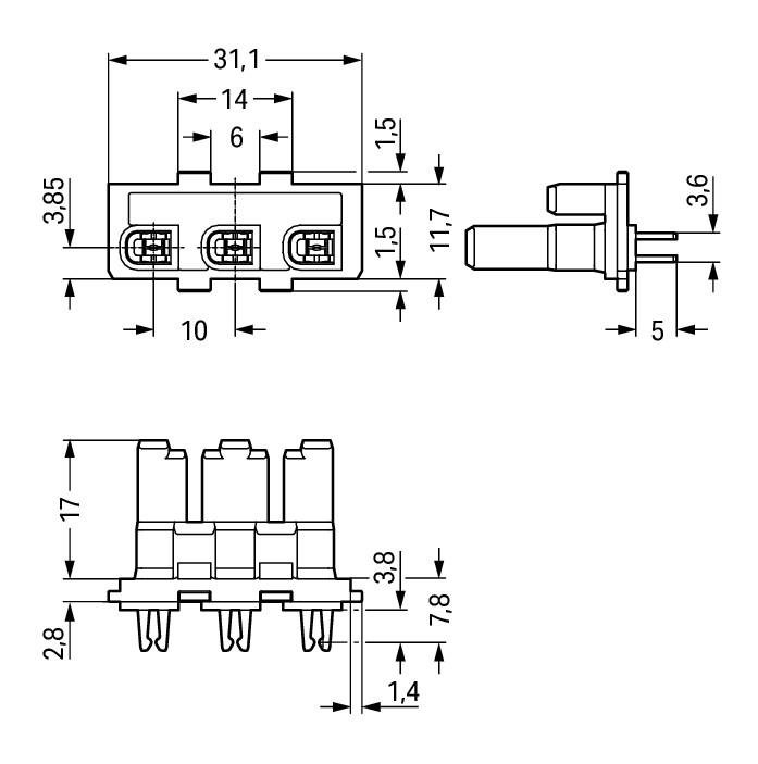

Clamping spring material | Chrome nickel spring steel (CrNi) |
Coding | A |
Цвет | white |
Connector connection type | for current bar |
Contact material | Copper or copper alloy, surface-treated |
Contact type (pluggable connector) | Female connector/socket |
Country of origin | DE |
Degree of protection | IP20 |
Габариты: глубина | 14.65 mm / 0.577 inch |
Fire load | 0.058 MJ |
GTIN | 4045454223137 |
Height | 24.8 mm / 0.976 inch |
Legend (ratings) | (III / 3) ≙ Overvoltage category III / Pollution degree 3 |
Locking lever | нет |
Locking of plug-in connection | locking lever |
Mating force of a plug-in connection | approx. 20 … 70 N (depending on pole number) |
Mismating protection | Yes |
Note (strip length) | see also packaging or instructions |
Number of Poles | 3 |
Pin spacing | 10 mm (0.394 inch) |
Product Group | 20 (WINSTA) |
Rated current | 25 A |
Rated impulse voltage (III / 3) | 4 kV |
Rated voltage (III / 3) | 250 В |
Retention force of a plug-in connection | when locked: > 80N |
Surrounding air (operating) temperature | -35 … 85 °C |
Total number of potentials | 3 |
Unmating force of a plug-in connection | when unlocked: approx. 20 … 70 N (depending on pole number) |
Вес | 4.025 г |
Ширина | 31.1 mm / 1.224 inch |
