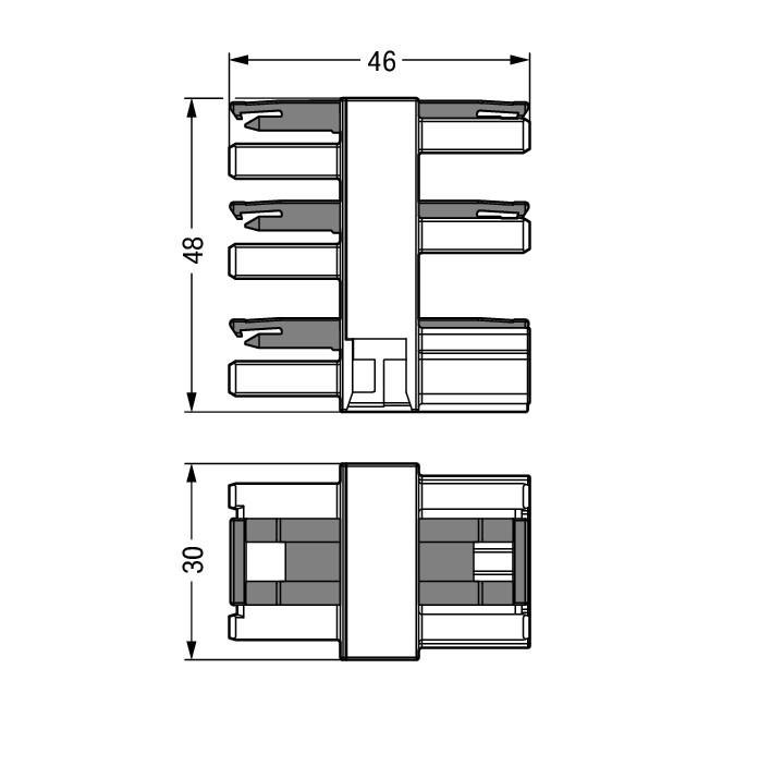

| Coding | A |
| Цвет | black |
| Contact material | Copper or copper alloy, surface-treated |
| Contact type (pluggable connector) | Socket/plug |
| Country of origin | DE |
| Degree of protection | IP20 |
| Габариты: глубина | 46 mm / 1.811 inch |
| Fire load | 0.561 MJ |
| Flammability class per UL94 | V0 |
| GTIN | 4045454251376 |
| Ground function | with preceding GND contact |
| Height | 48 mm / 1.89 inch |
| Insulating material | Polyamide 66 (PA 66) |
| Legend (ratings) | (III / 3) ≙ Overvoltage category III / Pollution degree 3 |
| Locking lever | да |
| Locking of plug-in connection | locking lever |
| Marking | L ⏚ N |
| Mating force of a plug-in connection | approx. 20 … 70 N (depending on pole number) |
| Mismating protection | Yes |
| Number of Poles | 3 |
| Pin spacing | 10 mm (0.394 inch) |
| Potential marking | L ⏚ N |
| Rated current | 25 A |
| Rated impulse voltage (III / 3) | 4 kV |
| Rated voltage (III / 3) | 250 В |
| Retention force of a plug-in connection | when locked: > 80N |
| Surrounding air (operating) temperature | -35 … 85 °C |
| Total number of potentials | 3 |
| Type of distribution connector | Distribution connector, 5-way |
| Unmating force of a plug-in connection | when unlocked: approx. 20 … 70 N (depending on pole number) |
| Вес | 37 г |
| Ширина | 30 mm / 1.181 inch |
