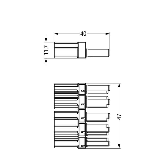

Промежуточный каплер; 1 штекер / 1 розетка; 5-пол.; 100% защита от неправильного подсоединения
INTERMEDIATE COUPLER 5-POLE COD. | |||
770-619 Wago | по запросу |
Coding | I |
Цвет | blue |
Contact material | Copper or copper alloy, surface-treated |
Contact type (pluggable connector) | Socket/plug |
Country of origin | DE |
Degree of protection | IP20 |
Габариты: глубина | 40 mm / 1.575 inch |
Fire load | 0.174 MJ |
GTIN | 4044918524179 |
Height | 11.6 mm / 0.457 inch |
Legend (ratings) | (III / 3) ≙ Overvoltage category III / Pollution degree 3 |
Locking lever | да |
Locking of plug-in connection | locking lever |
Mating force of a plug-in connection | approx. 20 … 70 N (depending on pole number) |
Mismating protection | Yes |
Number of Poles | 5 |
Pin spacing | 10 mm (0.394 inch) |
Rated current | 25 A |
Rated impulse voltage (III / 3) | 6 kV |
Rated voltage (III / 3) | 400 В |
Retention force of a plug-in connection | when locked: > 80N |
Surrounding air (operating) temperature | -35 … 85 °C |
Total number of potentials | 5 |
Type of distribution connector | Intermediate coupler |
Unmating force of a plug-in connection | when unlocked: approx. 20 … 70 N (depending on pole number) |
Вес | 9.584 г |
Ширина | 47 mm / 1.85 inch |
