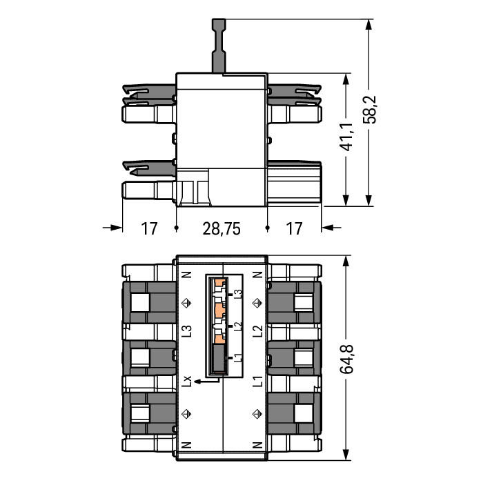

Распределительный соединитель с трех фаз на одну; 2 L2; 1 5-контактный штекер; 1 5-контактная розетка; 1 3-контактная розетка; 2 3-контактных розетки; 1 3-контактная розетка
Augswan
770-640
Wago
770640-4
CTS Electronic Components
770640-6
Wago 770-640
CodingA
Цветblack
Contact materialCopper or copper alloy, surface-treated
Contact type (pluggable connector)Socket/plug
Country of originDE
Degree of protectionIP20
Габариты: глубина62.75 mm / 2.47 inch
Fire load1.359 MJ
Flammability class per UL94V0
GTIN4045454530914
Height41.1 mm / 1.618 inch
Insulating materialPolyamide 66 (PA 66)
Legend (ratings)(III / 3) ≙ Overvoltage category III / Pollution degree 3
Locking leverда
Locking of plug-in connectionlocking lever
Mating force of a plug-in connectionapprox. 20 … 70 N (depending on pole number)
Mismating protectionYes
Number of Poles5
Pin spacing10 mm (0.394 inch)
Rated current25 A
Rated impulse voltage (III / 3)6 kV
Rated impulse voltage (III / 3) 24 kV
Rated voltage (III / 3)400 В
Rated voltage (III / 3) 2250 В
Retention force of a plug-in connectionwhen locked: > 80N
Surrounding air (operating) temperature-35 … 85 °C
Total number of potentials5
Type of distribution connectorThree-phase to single-phase distribution connector
Unmating force of a plug-in connectionwhen unlocked: approx. 20 … 70 N (depending on pole number)
Вес87.521 г
Ширина64.8 mm / 2.551 inch
