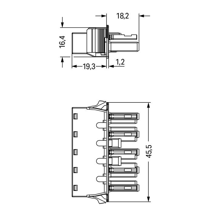

Защелкивающаяся розетка; с выступающим соединительным устройством; 5-пол.; Код. A
Augswan
770-725/009-000
Wago
Maybo
770-725/009-000
Wago
Wago 770-725/009-000
Actuation typeOperating tool Push-in
Clamping spring materialChrome nickel spring steel (CrNi)
CodingA
Цветwhite
Connection technologyPush-in CAGE CLAMP®
Connector connection typefor conductors
Contact materialCopper or copper alloy, surface-treated
Contact type (pluggable connector)Female connector/socket
Country of originDE
Degree of protectionIP20
Габариты: глубина37.5 mm / 1.476 inch
Designwith protruding interface
Fine-stranded conductor0.5 … 4 mm² / 20 … 12 AWG
Fine-stranded conductor with ferrule with plastic collar0.25 … 1.5 mm² / 20 … 16 AWG
Fine-stranded conductor with ferrule without plastic collar0.25 … 2.5 mm² / 20 … 14 AWG
Fine-stranded conductor with ferrule, push-in termination, from1.5 mm² / 16 AWG
Fire load0.289 MJ
Flammability class per UL94V0
GTIN4055143594134
Gehäuseblechstärke0.5 … 2 mm / 0.02 … 0.079 inch
Height18.5 mm / 0.728 inch
Insulating materialPolyamide 66 (PA 66)
Legend (ratings)(III / 3) ≙ Overvoltage category III / Pollution degree 3
Locking leverда
Locking of plug-in connectionlocking lever
MarkingN ⏚ L1 L2 L3
Mating force of a plug-in connectionapprox. 20 … 70 N (depending on pole number)
Mismating protectionYes
Mounting typeSnap-in
Nominal cross section4 mm²
Note (strip length)see also packaging or instructions
Number of Poles5
Pin spacing10 mm (0.394 inch)
Potential markingN ⏚ L1 L2 L3
Rated current25 A
Rated impulse voltage (III / 3)6 kV
Rated voltage (III / 3)400 В
Retention force of a plug-in connectionwhen locked: > 80N
Solid conductor0.5 … 4 mm² / 20 … 12 AWG
Solid conductor, push-in termination1.5 … 4 mm² / 16 … 12 AWG
Stranded conductor0.5 … 2.5 mm² / 20 … 14 AWG
Strip length9 mm / 0.35 Inch
Surrounding air (operating) temperature-35 … 85 °C
Total number of connection points10
Total number of potentials5
Unmating force of a plug-in connectionwhen unlocked: approx. 20 … 70 N (depending on pole number)
Вес16.71 г
Ширина55.5 mm / 2.185 inch
