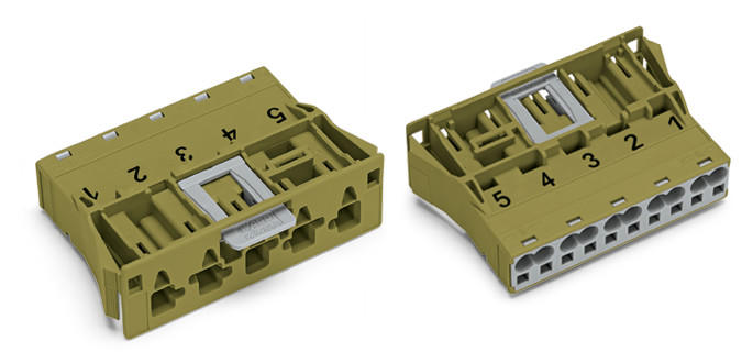

Datasheet Wago 770-775/073-000 — Даташит
Защелкивающийся штекер; 5-пол.; Код. B

Actuation type | Operating tool Push-in |
Clamping spring material | Chrome nickel spring steel (CrNi) |
Coding | B |
Цвет | light green |
Connection technology | Push-in CAGE CLAMP® |
Connector connection type | for conductors |
Contact material | Copper or copper alloy, surface-treated |
Contact type (pluggable connector) | Male connector/plug |
Country of origin | DE |
Degree of protection | IP20 |
Габариты: глубина | 36 mm / 1.417 inch |
Fine-stranded conductor | 0.5 … 4 mm² / 20 … 12 AWG |
Fine-stranded conductor with ferrule with plastic collar | 0.25 … 1.5 mm² / 20 … 16 AWG |
Fine-stranded conductor with ferrule without plastic collar | 0.25 … 2.5 mm² / 20 … 14 AWG |
Fine-stranded conductor with ferrule, push-in termination, from | 1.5 mm² / 16 AWG |
Fire load | 0.364 MJ |
GTIN | 4055143594394 |
Gehäuseblechstärke | 0.5 … 2 mm / 0.02 … 0.079 inch |
Height | 18.5 mm / 0.728 inch |
Legend (ratings) | (III / 3) ≙ Overvoltage category III / Pollution degree 3 |
Locking lever | да |
Locking of plug-in connection | locking lever |
Marking | 1 ⏚ 2 3 4 |
Mating force of a plug-in connection | approx. 20 … 70 N (depending on pole number) |
Mounting type | Snap-in |
Nominal cross section | 4 mm² |
Note (strip length) | see also packaging or instructions |
Number of Poles | 5 |
Pin spacing | 10 mm (0.394 inch) |
Potential marking | 1 ⏚ 2 3 4 |
Rated current | 25 A |
Rated impulse voltage (III / 3) | 6 kV |
Rated voltage (III / 3) | 400 В |
Retention force of a plug-in connection | when locked: > 80N |
Solid conductor | 0.5 … 4 mm² / 20 … 12 AWG |
Solid conductor, push-in termination | 1.5 … 4 mm² / 16 … 12 AWG |
Stranded conductor | 0.5 … 2.5 mm² / 20 … 14 AWG |
Strip length | 9 mm / 0.35 Inch |
Surrounding air (operating) temperature | -35 … 85 °C |
Total number of connection points | 10 |
Total number of potentials | 5 |
Unmating force of a plug-in connection | when unlocked: approx. 20 … 70 N (depending on pole number) |
Вес | 17.991 г |
Ширина | 55.5 mm / 2.185 inch |
