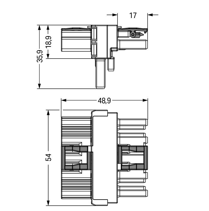

Т-образный распределительный соединитель; 1 штекер / 2 розетки; 5-пол.; 100% защита от неправильного подсоединения; съемные
| T-DISTRIBUTION CONNECTOR5-POLE COD. B, GRAY | |||
| 770-1641 Wago | по запросу | ||
| Coding | B |
| Цвет | gray |
| Contact material | Copper or copper alloy, surface-treated |
| Contact type (pluggable connector) | Socket/plug |
| Country of origin | DE |
| Degree of protection | IP20 |
| Габариты: глубина | 48.9 mm / 1.925 inch |
| Fire load | 0.513 MJ |
| Flammability class per UL94 | V0 |
| GTIN | 4050821702153 |
| Height | 36.1 mm / 1.421 inch |
| Insulating material | Polyamide 66 (PA 66) |
| Legend (ratings) | (III / 3) ≙ Overvoltage category III / Pollution degree 3 |
| Locking lever | да |
| Locking of plug-in connection | locking lever |
| Marking | 1 2 3 4 5 |
| Mating force of a plug-in connection | approx. 20 … 70 N (depending on pole number) |
| Number of Poles | 5 |
| Pin spacing | 10 mm (0.394 inch) |
| Potential marking | 1 2 3 4 5 |
| Product Group | 20 (WINSTA) |
| Rated current | 25 A |
| Rated impulse voltage (III / 3) | 6 kV |
| Rated voltage (III / 3) | 400 В |
| Retention force of a plug-in connection | when locked: > 80N |
| Surrounding air (operating) temperature | -35 … 85 °C |
| Total number of potentials | 5 |
| Type of distribution connector | T-distribution connector |
| Unmating force of a plug-in connection | when unlocked: approx. 20 … 70 N (depending on pole number) |
| Вес | 26.216 г |
| Ширина | 54 mm / 2.126 inch |
