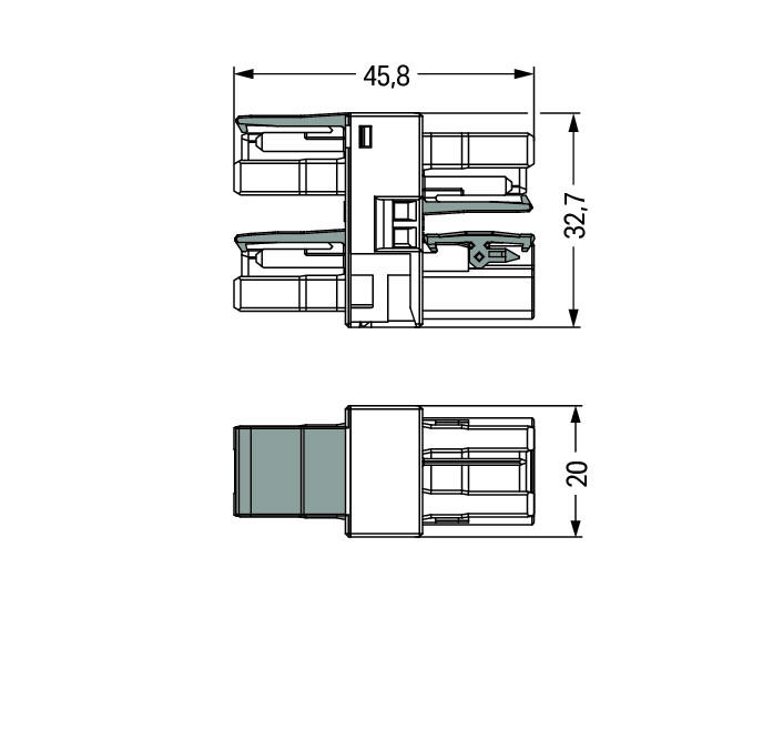

Datasheet Wago 770-1705 — Даташит
Распределительный соединитель; 3-канальные; 1 штекер / 3 розетки; 2-пол.
| Coding | B |
| Цвет | light green |
| Contact material | Copper or copper alloy, surface-treated |
| Contact type (pluggable connector) | Socket/plug |
| Country of origin | DE |
| Degree of protection | IP20 |
| Габариты: глубина | 45.8 mm / 1.803 inch |
| Flammability class per UL94 | V0 |
| GTIN | 4055143534369 |
| Height | 32.7 mm / 1.287 inch |
| Insulating material | Polyamide 66 (PA 66) |
| Legend (ratings) | (III / 3) ≙ Overvoltage category III / Pollution degree 3 |
| Locking lever | да |
| Locking of plug-in connection | locking lever |
| Marking | 1 2 |
| Mating force of a plug-in connection | approx. 20 … 70 N (depending on pole number) |
| Number of Poles | 2 |
| Pin spacing | 10 mm (0.394 inch) |
| Potential marking | 1 2 |
| Rated current | 25 A |
| Rated impulse voltage (III / 3) | 4 kV |
| Rated voltage (III / 3) | 250 В |
| Retention force of a plug-in connection | when locked: > 80N |
| Surrounding air (operating) temperature | -35 … 85 °C |
| Total number of potentials | 2 |
| Type of distribution connector | Distribution connector, 3-way |
| Unmating force of a plug-in connection | when unlocked: approx. 20 … 70 N (depending on pole number) |
| Вес | 17.724 г |
| Ширина | 20 mm / 0.787 inch |
