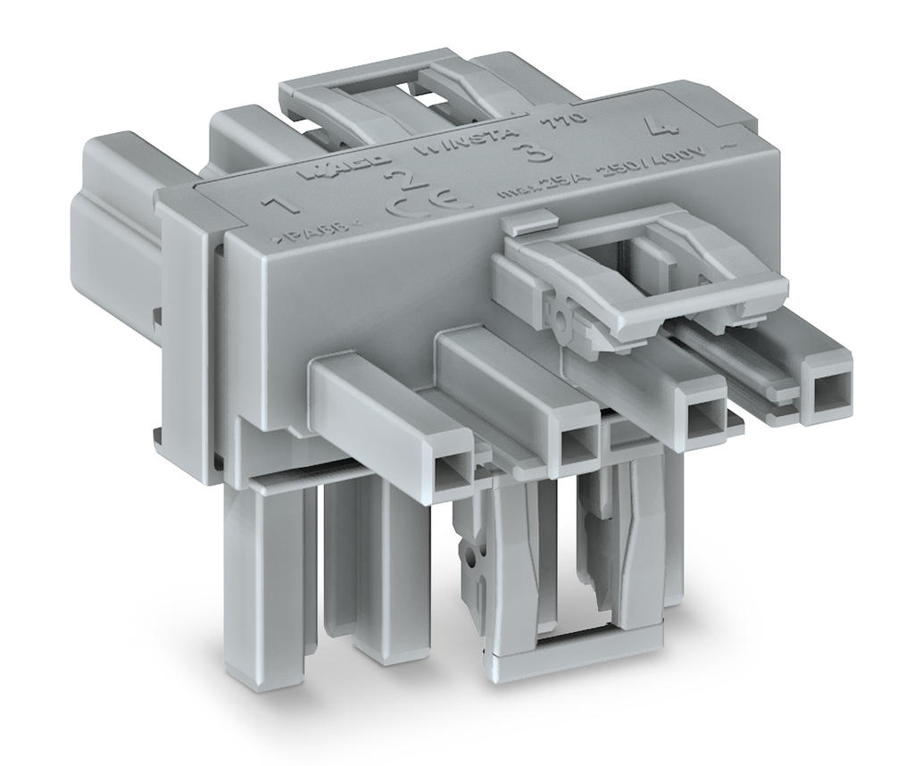

Datasheet Wago 770-1733 — Даташит
Т-образный распределительный соединитель; 1 штекер / 2 розетки; 4-пол.; для тонких проволочных выводов; с третьим фиксирующим рычагом; 100% защита от неправильного подсоединения; съемные
Coding | B |
Цвет | pink |
Contact material | Copper or copper alloy, surface-treated |
Contact type (pluggable connector) | Socket/plug |
Country of origin | DE |
Degree of protection | IP20 |

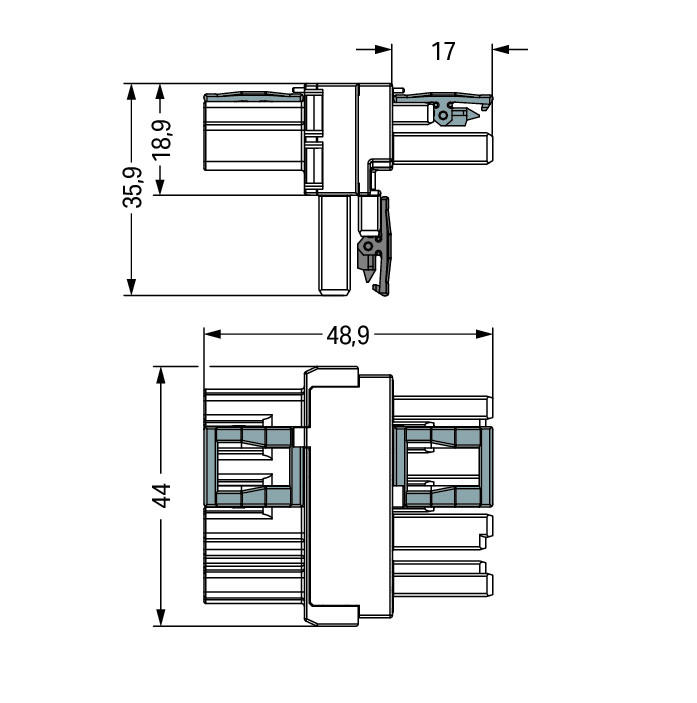

Габариты: глубина | 48.9 mm / 1.925 inch |
Fire load | 0.447 MJ |
GTIN | 4050821702184 |
Height | 36.1 mm / 1.421 inch |
Legend (ratings) | (III / 3) ≙ Overvoltage category III / Pollution degree 3 |
Locking lever | да |
Locking of plug-in connection | locking lever |
Marking | 1 2 3 4 |
Mating force of a plug-in connection | approx. 20 … 70 N (depending on pole number) |
Number of Poles | 4 |
Pin spacing | 10 mm (0.394 inch) |
Potential marking | 1 2 3 4 |
Product Group | 20 (WINSTA) |
Rated current | 25 A |
Rated impulse voltage (III / 3) | 6 kV |
Rated voltage (III / 3) | 400 В |
Retention force of a plug-in connection | when locked: > 80N |
Surrounding air (operating) temperature | -35 … 85 °C |
Total number of potentials | 4 |
Type of distribution connector | T-distribution connector |
Unmating force of a plug-in connection | when unlocked: approx. 20 … 70 N (depending on pole number) |
Вес | 22.199 г |
Ширина | 44 mm / 1.732 inch |
