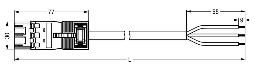

Соединительный кабель; Штекер - свободный конец; 3-пол.; длиной 3 м; Кодирование B; с изоляцией из ПВХ; Концы проводников, припаянные: 9 мм
771-4993/207-303 Wago | по запросу |
Coding | B |
Цвет | gray |
Color of sheathed cable | gray |
Conductor preparation | tip-bonded |
Connection type | Plug - free end |
Connector color | gray |
Contact material | Copper or copper alloy, surface-treated |
Country of origin | DE |
Cross section of single conductor | 2.5 mm² |
Degree of protection | IP20 |
Durchmesser der Mantelleitung | 9.2 … 11.4 mm |
Fire load | 7.234 MJ |
GTIN | 4050821667575 |
Legend (ratings) | (III / 3) ≙ Overvoltage category III / Pollution degree 3 |
Locking lever | нет |
Locking of plug-in connection | locking lever |
Marking | 1 2 3 |
Mating force of a plug-in connection | approx. 20 … 70 N (depending on pole number) |
Number of Poles | 3 |
Pin spacing | 10 mm (0.394 inch) |
Potential marking | 1 2 3 |
Printing color of mating face | black |
Printing color of sheathed cable | black |
Printing color of strain relief | white |
Rated current | 20 A |
Rated impulse voltage (III / 3) | 4 kV |
Rated voltage (III / 3) | 250 В |
Reaction to fire class per EN 50575 | Eca |
Retention force of a plug-in connection | when locked: > 80N |
Sheath material | PVC |
Strain relief color | black |
Strip length | 55 мм |
Surrounding air (operating) temperature | -35 … 85 °C |
Total length | 3 m |
Total number of potentials | 3 |
Type of cable | Control line 3 x 2.5 |
Type of cable assembly | Connecting cable |
Unmating force of a plug-in connection | when unlocked: approx. 20 … 70 N (depending on pole number) |
