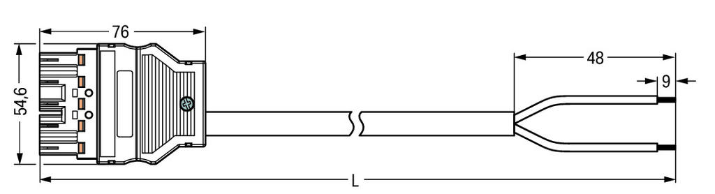

Datasheet Wago 771-5001/218-000 — Даташит
предварительно собранный соединительный кабель; Cca; вилка/открытый конец; 5-полюсный; Код I; H05Z1Z1-F 2 x 1,50 мм²; 6 м
Счётчик горячей и холодной воды Декаст СТВУ 77-150-01 используется для измерения суммарного расхода горячей и холодной питьевой и сетевой воды в... | |||
СТВУ 77-150-01 | 45 120 ₽ | ||
771-5001/186-000 Wago | по запросу |
Цвет | blue |
Connection type | Plug - free end |
Contact material | Copper or copper alloy, surface-treated |
Continuous operating temperature | −35 … +85 °C |
Country of origin | DE |
Degree of protection | IP20 |
Fire load | 0.678 MJ |
GTIN | 4055143810685 |
Legend (ratings) | (III / 3) ≙ Overvoltage category III / Pollution degree 3 |
Locking lever | нет |
Locking of plug-in connection | locking lever |
Mating force of a plug-in connection | approx. 20 … 70 N (depending on pole number) |
Mismating protection | Yes |
Note on Continuous Service Temperature | PVC cable for temperatures ≤ 70 °C (including halogen-free)Insulating parts for temperatures ≤ 105 °C |
Note on Protection Type | Only in mated condition with strain relief housing (These compact connectors are not designed for use in open, easily accessible areas) |
Packaging type | not packed |
Pin spacing | 10 mm (0.394 inch) |
Processing temperature | -5 … +40 °C |
Reaction to fire class per EN 50575 | Eca |
Retention force of a plug-in connection | when locked: > 80N |
Strip length | 48 мм |
Unmating force of a plug-in connection | when unlocked: approx. 20 … 70 N (depending on pole number) |
Вес | 507.916 г |
