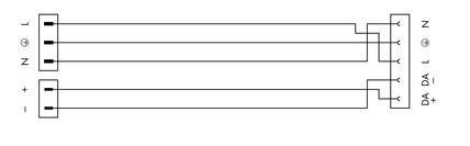

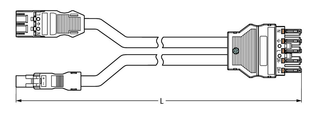

предварительно собранный Y-кабель; B2ca; 2 x вилка/розетка; 3-полюсный + 2-полюсный/5-полюсный; Код A/I; H05Z1Z1-F 2 x 1,50 мм²; H05Z1Z1-F 3G 2,5 мм²; 0,5 м

Цветblack/blue
Connection typePlug (MIDI); Plug (MINI)
Contact materialCopper or copper alloy, surface-treated
Continuous operating temperature−35 … +85 °C
Country of originDE
Degree of protectionIP20
Fire load0.703 MJ
Flammability class per UL94V0
GTIN4055143811989
Insulating materialPolyamide 66 (PA 66)
Legend (ratings)(III / 3) ≙ Overvoltage category III / Pollution degree 3
Locking leverнет
Locking of plug-in connectionlocking lever
Mating force of a plug-in connectionapprox. 20 … 70 N (depending on pole number)
Mismating protectionYes
Note on Continuous Service TemperaturePVC cable for temperatures ≤ 70 °C (including halogen-free)Insulating parts for temperatures ≤ 105 °C
Note on Protection TypeOnly in mated condition with strain relief housing (These compact connectors are not designed for use in open, easily accessible areas)
Packaging typenot packed
Pin spacing10 mm (0.394 inch)
Processing temperature-5 … +40 °C
Reaction to fire class per EN 50575Eca
Retention force of a plug-in connectionwhen locked: > 80N
Unmating force of a plug-in connectionwhen unlocked: approx. 20 … 70 N (depending on pole number)
