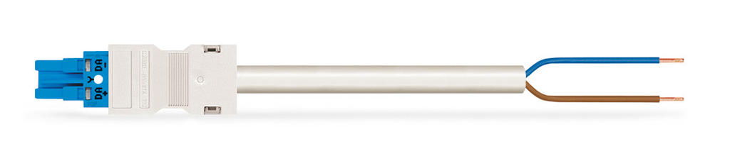

предв. собранный соединительный кабель; Eca; Розетка/открытая; 2-пол.; Код. I; H05VV-F 2 x 1,0 мм²; 3 м
771-8982/106-802 Wago | по запросу |
Coding | I |
Цвет | blue |
Color of sheathed cable | white |
Conductor preparation | tip-bonded |
Connection type | Socket - free end |
Connector color | blue |
Contact material | Copper or copper alloy, surface-treated |
Country of origin | DE |
Cross section of single conductor | 1 mm² |
Degree of protection | IP20 |
Durchmesser der Mantelleitung | 5.9 … 7.5 mm |
Fire load | 3.705 MJ |
GTIN | 4050821103233 |
Legend (ratings) | (III / 3) ≙ Overvoltage category III / Pollution degree 3 |
Locking lever | нет |
Locking of plug-in connection | locking lever |
Marking | DA+ DA- |
Mating force of a plug-in connection | approx. 20 … 70 N (depending on pole number) |
Mismating protection | Yes |
Number of Poles | 2 |
Pin spacing | 10 mm (0.394 inch) |
Potential marking | DA+ DA- |
Printing color of mating face | black |
Printing color of sheathed cable | black |
Printing color of strain relief | black |
Rated current | 10 A |
Rated impulse voltage (III / 3) | 4 kV |
Rated voltage (III / 3) | 250 В |
Reaction to fire class per EN 50575 | Eca |
Retention force of a plug-in connection | when locked: > 80N |
Sheath material | PVC |
Strain relief color | white |
Strip length | 35 мм |
Surrounding air (operating) temperature | -35 … 85 °C |
Total length | 3 m |
Total number of potentials | 2 |
Type of cable | H05VV-F 2x1 |
Type of cable assembly | Connecting cable |
Unmating force of a plug-in connection | when unlocked: approx. 20 … 70 N (depending on pole number) |
Вес | 182.913 г |
