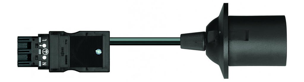

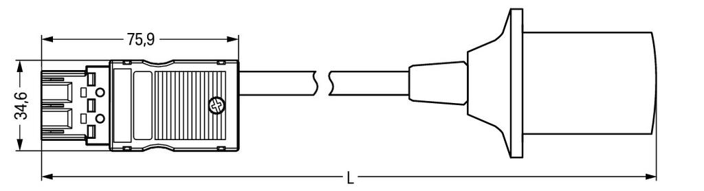

Datasheet Wago 771-8993/1004-051 — Даташит
предв. собранный кабель с адаптером; Штекер/патрон лампы E 27; 3-пол.; Код. A; 0,5 м
Coding | A |
Цвет | black |
Color of sheathed cable | black |
Conductor preparation | tip-bonded |
Connection type | Plug - E 27 lamp socket |
Connector color | black |
Contact material | Copper or copper alloy, surface-treated |
Country of origin | DE |
Cross section of single conductor | 0.75 mm² |
Degree of protection | IP20 |
Durchmesser der Mantelleitung | 5.7 … 7.2 mm |
Fire load | 30.473 MJ |
GTIN | 4045454071646 |
Ground function | with preceding GND contact |
Legend (ratings) | (III / 3) ≙ Overvoltage category III / Pollution degree 3 |
Locking lever | нет |
Locking of plug-in connection | locking lever |
Marking | L ⏚ N |
Mating force of a plug-in connection | approx. 20 … 70 N (depending on pole number) |
Mismating protection | Yes |
Number of Poles | 3 |
Pin spacing | 10 mm (0.394 inch) |
Potential marking | L ⏚ N |
Printing color of mating face | white |
Printing color of sheathed cable | white |
Printing color of strain relief | white |
Rated current | 10 A |
Rated impulse voltage (III / 3) | 4 kV |
Rated voltage (III / 3) | 250 В |
Reaction to fire class per EN 50575 | Eca |
Retention force of a plug-in connection | when locked: > 80N |
Sheath material | PVC |
Strain relief color | black |
Surrounding air (operating) temperature | -35 … 85 °C |
Total number of potentials | 3 |
Unmating force of a plug-in connection | when unlocked: approx. 20 … 70 N (depending on pole number) |
Вес | 62 г |
