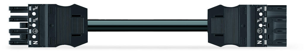

Datasheet Wago 771-9294/016-401 — Даташит
предв. собранный межблочный кабель; B2ca; Розетка - штекер; 4-пол.; Код. A; 4m
Coding | A |
Цвет | black |
Color of sheathed cable | black |
Connection type | Socket - Plug |
Connector color | black |
Contact material | Copper or copper alloy, surface-treated |
Country of origin | DE |
Cross section of single conductor | 1.5 mm² |
Degree of protection | IP20 |
Durchmesser der Mantelleitung | 8.4 … 10.5 mm |
GTIN | 4055143786140 |
Ground function | with preceding GND contact |
Halogen-free | Yes |
Legend (ratings) | (III / 3) ≙ Overvoltage category III / Pollution degree 3 |
Locking lever | нет |
Locking of plug-in connection | locking lever |
Marking | N ⏚ 2|L 1|L' |
Mating force of a plug-in connection | approx. 20 … 70 N (depending on pole number) |
Mismating protection | Yes |
Number of Poles | 4 |
Packaging type | not packed |
Pin spacing | 10 mm (0.394 inch) |
Potential marking | N ⏚ 2/L 1/L' |
Printing color of mating face | white |
Printing color of sheathed cable | white |
Printing color of strain relief | white |
Rated current | 16 A |
Rated impulse voltage (III / 3) | 6 kV |
Rated voltage (III / 3) | 400 В |
Reaction to fire class per EN 50575 | B2ca |
Retention force of a plug-in connection | when locked: > 80N |
Strain relief color | black |
Surrounding air (operating) temperature | -35 … 85 °C |
Total length | 4 m |
Total number of potentials | 4 |
Type of cable | H05Z1Z1-F 4G1.5 |
Type of cable assembly | Interconnecting cable |
Unmating force of a plug-in connection | when unlocked: approx. 20 … 70 N (depending on pole number) |
Вес | 540.89 г |
